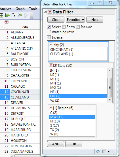

The following example illustrates how the Conditional option helps show the subcategories clearly, without the extra categories that do not belong.
Select Rows > Data Filter.
Select Conditional from the Data Filter red triangle menu.
5.
Select MW in the Region list.
6.
Select OH from the State list.
The cities that are in Ohio and in the Midwest region are selected in the data table. In the Data Filter window, only Midwestern states appear in the State list, and only cities in Ohio appear in the cities list. See Using the Conditional Option.
The bracketed number in front of the column name indicates the order in which the column values were selected. In Using the Conditional Option, Region was selected first, so it has a [1] in front of the column name. State was selected second, so it has a [2] in front of the column name.

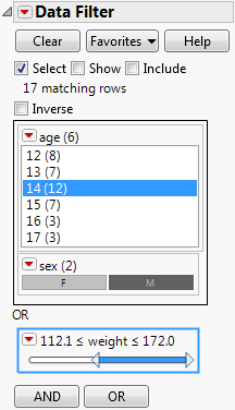

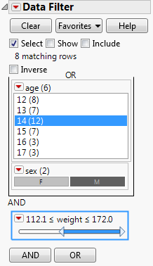

You can reverse the AND and OR behavior by selecting Grouped by AND from the red triangle menu.
5.
6.
7.
14-year-old males or students who weigh greater than 112 are selected.
8.
Select Grouped by AND from the Data Filter red triangle menu.
