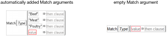

After you select Match in the Formula Editor, a list appears with two options:
Select Add Match Arguments from Data, and clauses that correspond to all of the levels in your data are added automatically. Alternatively, hold down the SHIFT key, select Conditional, and then select Match. In Examples of Using the Match Function, the example on the left shows clauses that were added automatically.
Select Don’t Add so that you can add each clause individually. In Examples of Using the Match Function, the example on the right shows an empty clause, which you fill with the missing expressions.
In an automatically filled argument, you should highlight then clause, and then enter an expression. In an empty argument, you highlight either expr, value, or then clause, and then enter an expression. (Or, if you highlight an expression and click Match, the Formula Editor creates a new Match conditional, with the original highlighted expression as expr and nothing for the value and else clause.) Also, keep in mind that:
