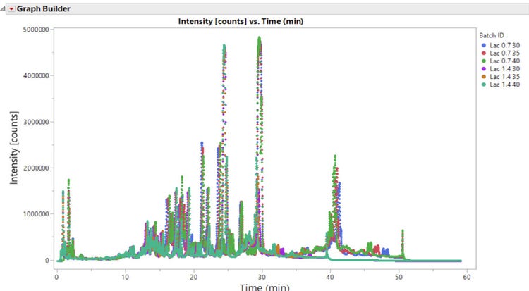

- Use functional data analysis to understand how the curve shape changes as factors change.
- Identify optimized conditions for the separation of the two peaks.
To improve the separation of the two peaks with the HPLC, two control parameters were chosen to be changed: the mobile phase flow rate and the column temperature. The temperature was altered to 30, 35, or 40°C, and the flow rate to 0.7 or 1.4 mL/min.
