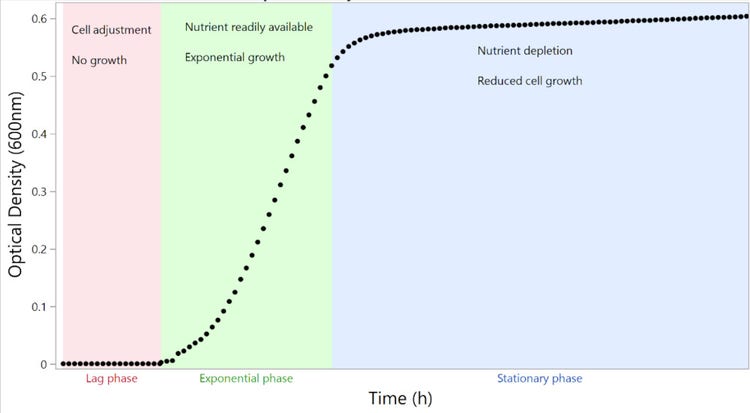

The growth of bacteria generally follows a set growth profile that represents different phases of growth. Scientists are interested in capturing the occurrence of these stages to learn more about their microbe of study and to improve processes. The primary stages of growth are:
- Lag phase: The initial period where cells are inoculated and acclimate to their conditions (environmental and media). In production processes, scientists want to ensure that the lag phase is as short as possible to reduce the total production time and reduce costs.
- Exponential phase: The period of exponential growth of the cells as they consume a readily available supply of nutrients. The growth rate during this stage is important to understand, as desirable rates are a balance between quick growth (reducing production time) and avoiding overwhelming a fermenter (i.e., consuming too much oxygen and nutrients leading to faster cell death). The midpoint of this phase (the midexponential) is a key characteristic that is considered when transferring seed/starting cultures into production processes.
- Stationary phase: The period when nutrients begin to deplete or toxic by-products begin to accumulate, leading to an equal portion of cell death and cell growth. The time that this occurs and the maximum value of biomass that is achieved are important as we often need processes that create high biomass and, in some cases, desired products are only expressed during the stationary phase. In this example, the stationary phase is not completely flat; even when a primary nutrient is depleted or toxins accumulate, cells can still grow (slowly) on alternative nutrients, if available.
- Death phase: The period when cells exhaust all nutrients or toxins build up to a level above tolerance. Cell death typically marks the end of a productive process, so knowing when it occurs can help inform when a production needs to stop.
When trying to analyze a growth curve, scientists want to profile the whole curve shape and find parameters that best represent each of these stages, which can be achieved with nonlinear regression/curve fitting.
