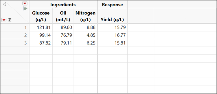

Suppose you have a chemical formulation and need to maximize its yield above 30 g/L. To be first to market, you need to find the ideal amounts of each chemical to maximize your yield efficiently, cutting out unnecessary experimentation. Similar to the dark room example above, you can use Bayesian optimization to learn from response data, which points you in the direction of the optimal formulation.
Assuming you have some historical data from past experiments, you use it to construct an initial model. In this example, there are three observations:

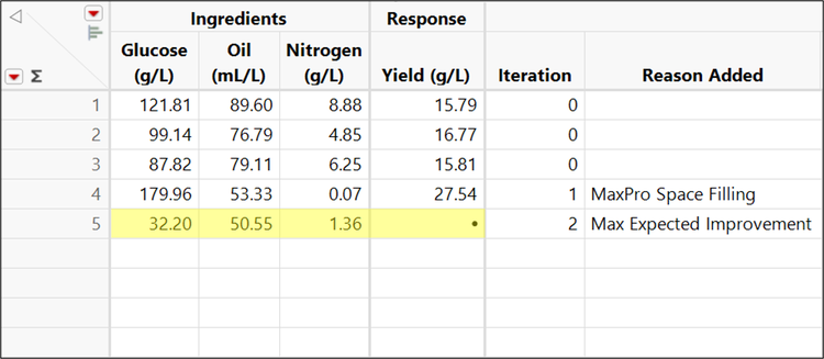

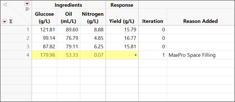

Next, the Bayesian Optimization platform in JMP Pro fits models to your data and recommends a new chemical formulation to maximize yield (Row 4). Use those three ingredient amounts to run the next experiment.
After recording the results in the data table (Row 4, Yield column), the platform learns from the most recent test results and suggests additional experiments to find an optimum.
Note that the Reason Added column identifies the platform’s strategy for selecting these test settings, in this case, Maximum Expected Improvement.

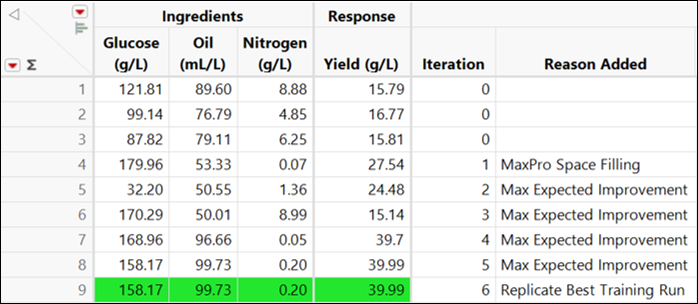

This guided process repeats until the product goals are satisfied.
In the final iteration (Row 9), the Reason Added column changes to Replicate Best Training Run, indicating that the optimum has likely been found. Notice the Yield has successfully been maximized above 30 g/L using only six iterations from the Bayesian Optimization platform.
JMP Pro’s Bayesian Optimization platform won’t spend too much time experimenting in undesirable regions that produce a low yield and where formulations don’t meet the goal. Instead, it seeks to find high-performing solutions that produce a maximum yield, while adequately searching the design space to ensure that the optimum has been found. The iterative process of testing and learning is a "smart" way to learn quickly, efficiently revealing an optimal formulation that meets all goals.

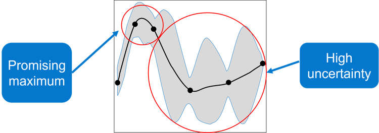

Since Bayesian optimization is an iterative experimentation approach, you need to know where to run your next test. To ensure you are sampling your design space with your goals in mind, Bayesian optimization uses acquisition functions.
Acquisition functions use the Gaussian process model to intelligently decide where to experiment next. Some acquisition functions prioritize regions that are likely to improve upon the best solution so far, while others find the most possible new information. More specifically, they use the Gaussian process to sample regions that show promise of containing the optimum or areas with high uncertainty (areas that have not been explored).
Gaussian process model with circled regions demonstrates a region of promise for finding a maximum and the areas that may need further exploration.
