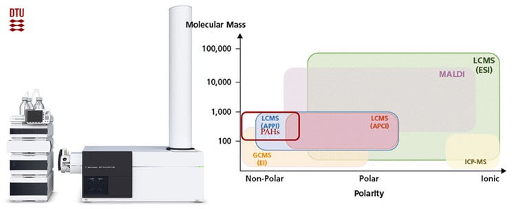

For PAH monitoring, atmospheric pressure photoionization (APPI) provides the best performance among LC-compatible ionization techniques that can be coupled with HRMS. With only an atmospheric pressure chemical ionization (APCI) available however, Ionas has worked to develop a more comprehensive analysis approach that could be used both in contaminant monitoring and potentially even chemometric approaches in food safety.

Ionas explains that the team turned to a liquid-chromatography high-resolution mass-spectrometry (LC-HRMS) instrument using APCI ionization because of fitness-for-purpose and availability. But Ionas says APCI works best for compounds that have low to medium molecular mass and are in a medium polarity range, making the technique suboptimal for nonpolar chemicals like PAHs.

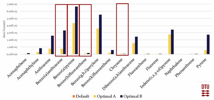

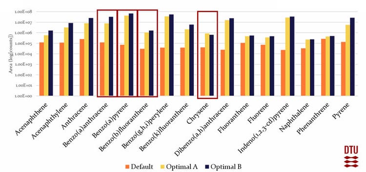

Results default vs. optimal parametersIncrease in signal from 1.3E+03 to 8.2E+05 as compared to defaultFor PAH4: from 3.0E+04 to 5.3E+05

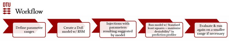

Ionas set up a response surface model using the JMP Custom Design platform. By default, the platform uses the recommended optimality criterion based on whether quadratic effects are added in the model outline. After testing several suggested combinations of factors, Ionas created individual methods for each combination. Setting the mass spectrometer to perform injections automatically overnight and automating data extraction, he then plugged the data back into JMP to figure out how well it worked and which parameters to optimize further.
For the experiment’s first iteration, Ionas kept the factors as broad as possible so as to surface potential optimization opportunities. He included the four most important PAHs, plus 12 additional PAH chemicals, some of which are either known or suspected carcinogens by the EU Scientific Committee for Food (SCF 2002). Ionas assigned a numerical importance to each as a model input, and he says, “I found JMP to be straightforward to use and quite powerful.”
In the end, Ionas was able to optimize APCI source parameters to achieve a significant increase in PAH response. Compared to the instrument’s default set of source parameters, multivariate optimization increased signal by between 170 and 120,000 percent. The method produced higher increases for those analytes with a higher level of importance, he notes, and less for the others.
