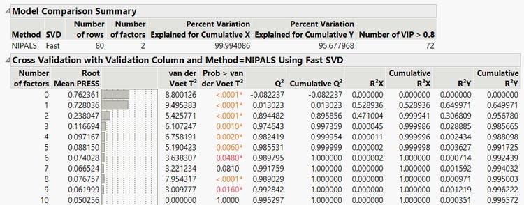

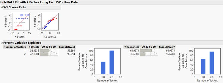

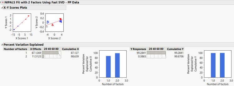

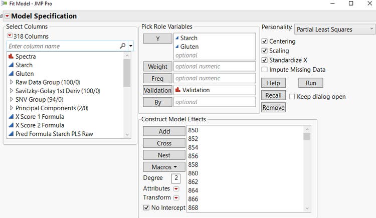

The PLS model was built with two latent factors because previous principal component analysis used two principal components. Also, Q2 does not improve much beyond two factors, and adding more factors makes model interpretation more difficult.
Figure 1. Partial Least Squares model set up and output.
Figure 2. Partial Least Squares model with Raw data.
Figure 3. Partial Least Squares model with Pre-Processed data.

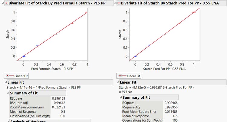

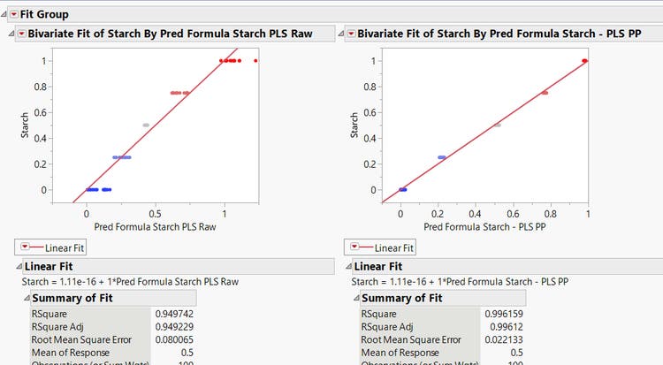

Below is a comparison of the Actual by Predicted Plot for both PLS models. The one on the left is for the raw data, and the one on the right is using the pre-processed data. As you can see, there is a significant improvement in the model using the pre-processed data.
Figure 4. Partial Least Squares model comparison with Raw and Pre-Processed data.

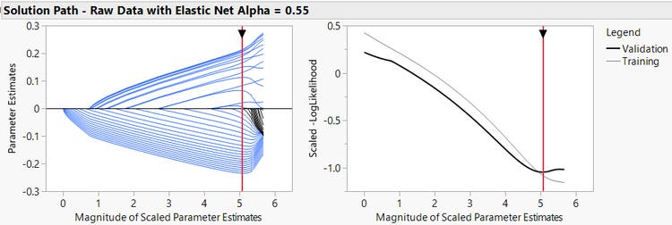

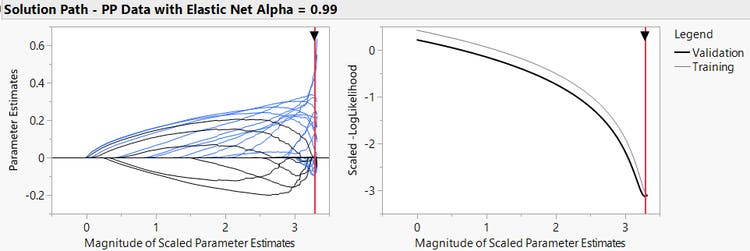

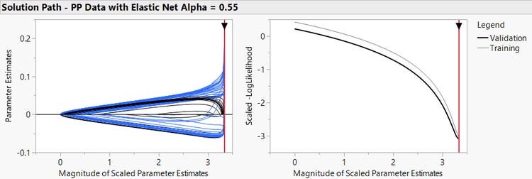

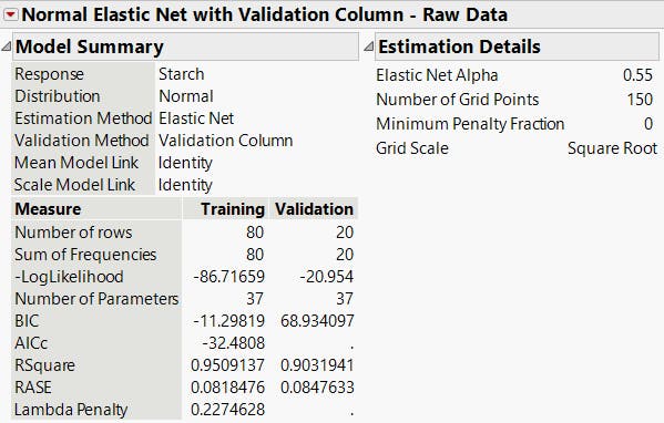

Generalized Regression techniques are found in JMP Pro. Gen Reg gives you at least two things you will not get out of ordinary Least Squares. One is that with Gen Reg, your data doesn’t have to be normally distributed. You have options for many different types of distributions. Another difference is that Gen Reg includes the Penalized Regression technique, and it handles highly correlated data very well. Gen Reg provides Ridge, Lasso, and Elastic Net. Elastic Net is a nice compromise for modeling spectral data because you can adjust the Elastic Net Alpha (ENA) penalty to keep from underfitting a model by rejecting to many highly correlated factors as important to the model. The default value of 0.99 ENA was used to build an initial model. This model appeared to be rather sparse and potentially underfit. An advanced option in Gen Reg was used to scan the range of alpha values to see if there was a better model. This scan provided a better fit using an ENA value of 0.55. You can see the difference in the fit for the two ENA values in the solution paths below.
Figure 5 – Elastic Net solution paths for Raw data.
Figure 6 - Fit Statistics for Gen Reg with Raw Data.

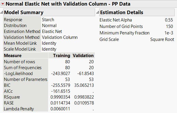

Figure 7 - Elastic Net solution paths for Pre-Processed data.
Figure 8 - Fit Statistics for Gen Reg with Pre-Processed Data.
Without going into more detail, the fit for the raw data used 10 wavelengths when the Elastic Net Alpha (ENA) was 0.99 and 37 wavelengths when ENA was 0.55.
The pre-processed data has a significantly different outcome. Using Elastic Net again, there were 22 significant wavelengths found using an ENA of 0.99 and 53 significant wavelengths using an ENA of 0.55. While a large number, 37 and 53 of significant wavelengths identified with ENA of 0.55, both results are less than the PLS models by a large margin. Checking the fit statistics for both sets of models shows the pre-processed data to have the better overall predictive model. However, if you only used raw data, you would still be able to come up with a reasonably good predictive model.

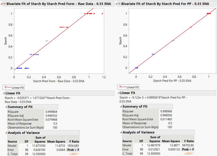

Figure 9 – Model comparison for Gen Reg with Raw and Pre-Processed Data.
A comparison of PLS and ELN models using processed data shows ELN models are only slightly better based on R2. However, the ELN models are simpler and easier to interpret.
Figure 10 – Comparison of PLS and ELN modeling techniques for processed data.

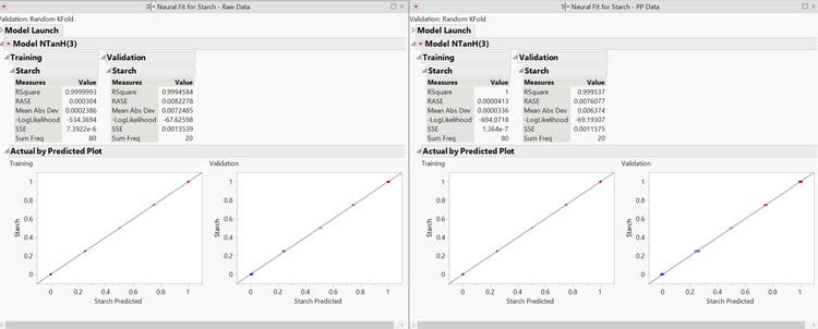

For demonstration purposes, you can also use neural net models, which in this case show extremely good fits but are highly complex models.
However, the Prediction Profiler in JMP enables users to interpret even the most complex, nonlinear models. The Profiler can be overwhelming when all wavelengths are used for prediction. To keep the neural net model simpler, you can provide the wavelengths selected with Gen Reg in the model dialog.
Figure 11 – Comparison of Neural Net fits for raw and pre-processed data.
In both cases, the data was fit with one hidden layer and three nodes with a hyperbolic tangent activation function using a fixed 20% validation column for cross-validation.

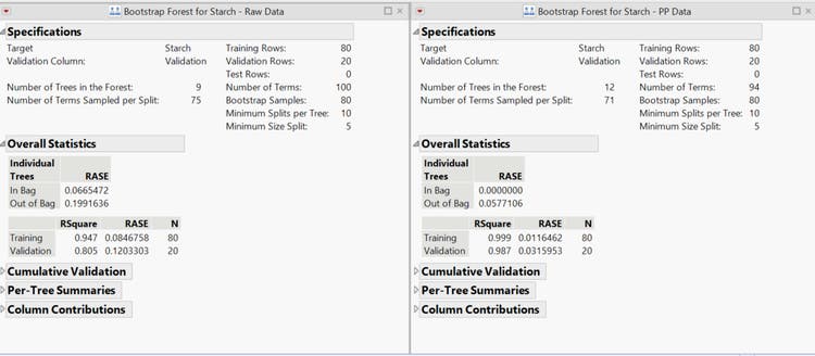

Using a Bootstrap Forest approach gives the most significant wavelengths for a given set of spectra. It is also a clear indication that pre-processing gives a much better model. The difference is based on the Validation R2 for each data set. The Validation R2 for the raw data is 0.805, and for the processed data the Validation R2 is 0.987. The models below were fit using a fixed 20% of the data as a validation set to avoid a random selection of the validation set.
Figure 12 – Comparison of Bootstrap Forest fits for Raw and Pre-Processed data.

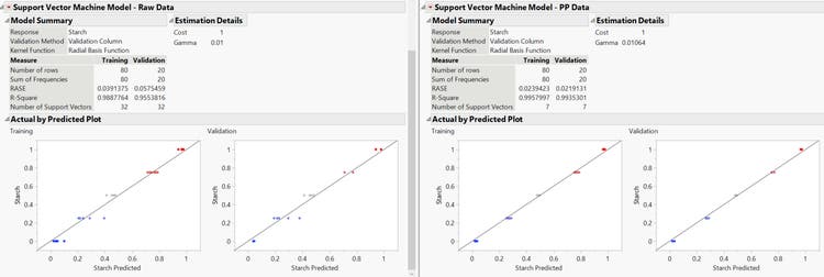

Support Vector Regression (SVR) modeling is also available in JMP Pro, and it is another good alternative for analyzing spectral data. SVR is a powerful and flexible boundary-based machine learning algorithm used to build predictive models for a continuous response. In the case of our data set, SVR also shows a significant improvement when analyzing processed data.
Figure 13 - Comparison of SVR model fits for Raw and Pre-Processed data.
