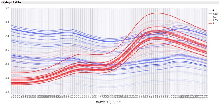

Figure 1 shows a line plot of the spectra in Graph Builder. With your data in the stacked format, drag the X and Y variables to their respective axis, and use the spectra ID as the overlay variable. Alternatively, you can use the Launch Graph Builder command in Spectra Tools. For the color variable, we use the response variable of interest, which is gluten content.
Figure 1.

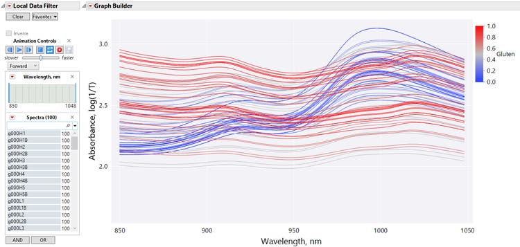

To zoom into regions of interest (ROIs), click and drag the X axis. You can create a Local Data Filter in the red triangle menu for a few other useful controls. This is provided by default in Spectral Tools. These are shown on the left of Figure 1. The wavelength local data filter can be used to focus on a region of interest (ROI). To create a new data table for just the ROI data, go to the local data filter red triangle and select Show Subset. Also, to only show a subset of the spectra on the graph, select the spectra in the spectra ID Local Data Filter. You can also use the Animation Controls to cycle through one spectra at a time.

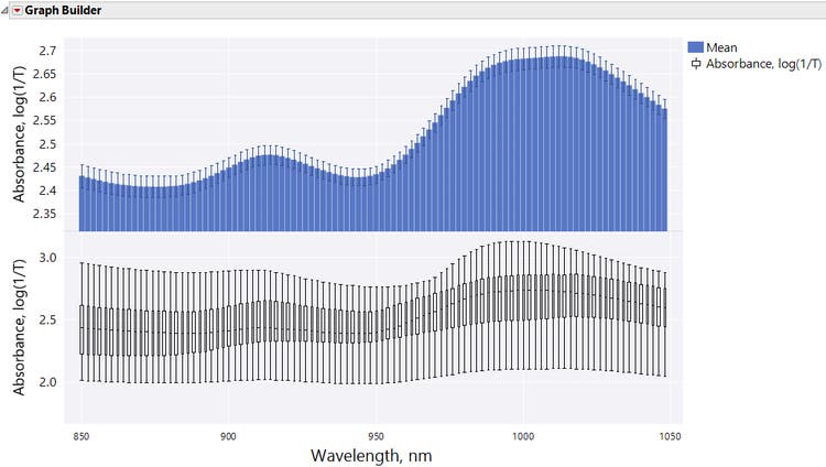

Other summary measures that will quantify the quality of spectra are accessible in Graph Builder. To create these, remove the overlay variable so that the mean spectra is shown. Then, selecting the bar plot and box plot options will generate the plots in Figure 3. Variation that is constant across wavelengths often indicates noise – and a need for further pre-processing – whereas large variation that is specific to certain wavelengths may indicate real chemical effects.

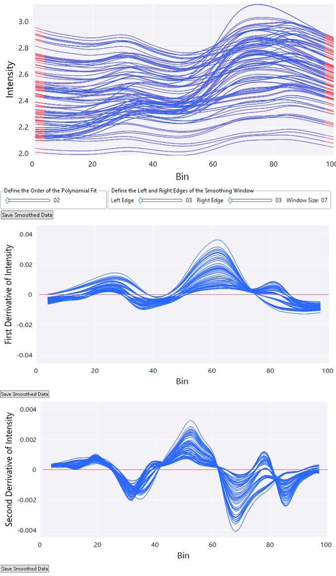

For the first step, we will remove the apparent baseline shifts in the spectra. For this, we use a SG data filtering add-in developed by Ian Cox (see the add-in attached to this post below). This will only accept data in a wide format. Choose the “Data Filtering” add-in from the list of installed add-ins in JMP. Select the columns to be manipulated and select OK. Three output graphs will pop up for review.
The SG smoother user interface is where the polynomial order of fit, 2 – 8) is defined, and the length of the right and left edges of the smoothing window are also defined. Changing any of these values automatically updates the graphs, since the derivatives are performed on the SG smoothed spectra. Since derivative filters amplify noise, a certain degree of smoothing is often required. Figure 5 shows the output graphs.
Figure 5.
The filtered data can be saved to a new data table, which can then be transferred back to the original data table for further pre-processing if desired. In this case, the first derivative data was selected and saved back to the original data table.

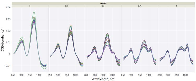

This appeared to effectively remove the baseline shifts. However, there is still some scatter effects remaining in the spectra. One way to visually separate out the scatter effects and chemical effects is to use a grouping variable in Graph Builder. Move the gluten content variable to the one of the group axes. Graph Builder will find a sensible binning and create separate panels for each bin. In these data, we only have 5 values of gluten content. Scatter effects remain because the first derivative removed the additive baseline shift, but did not remove the multiplicative scatter effect. We will show how to illustrate multiplicative scatter effects with a scatter effects plot in the next article.
Figure 6.

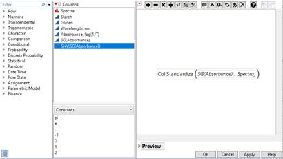

To remove the remaining scatter effect, we perform a SNV standardization. SNV requires the data to be in a stacked format. We create a new column and add the formula shown in Figure 7.

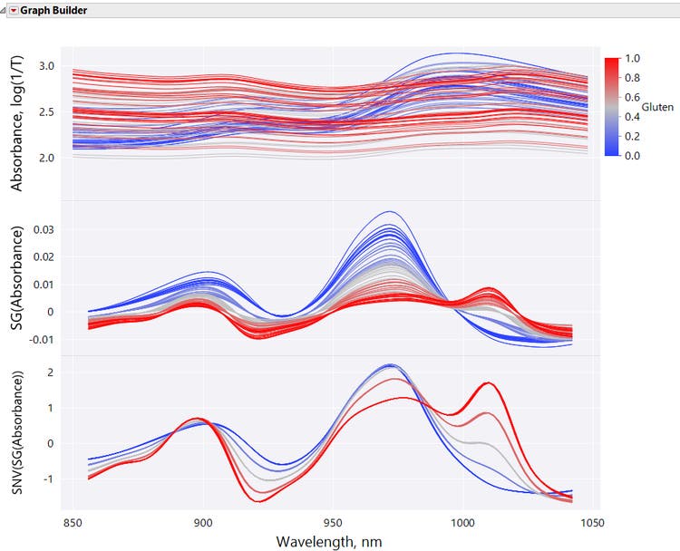

The raw spectra and final pre-processed spectra are shown in Figure 8. To easily launch a plot like this, use the Launch Graph Builder command in Spectra Tools.
These simple steps have already resulted in a much easier to interpret spectra, with baseline shifts and multiplicative scatter effects removed. In their original paper, Martens et al. demonstrated how the more advanced extended multiplicative signal correction can further improve on this pre-processing workflow. We will cover this in the next article.
