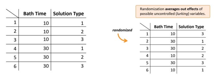

For each trial in the experiment, or experimental run, you apply a treatment and record the response. When you randomize the experiment, you run the treatments in random order. Randomization averages out the effects of uncontrolled (or lurking) variables.
Let’s look at an example. Suppose you are studying a cleaning process for titanium parts, with two factors, Bath Time and Solution Type. You conduct the experiment without randomization. It takes one day to conduct all six trials. You run all of the treatments with Bath Time at 10 minutes in the morning, and all of the treatments with Bath Time at 30 minutes in the afternoon. Meanwhile, the ambient temperature and humidity both increase throughout the day.
Two tables showing treatment combinations before and after randomization to reduce effects of lurking variables.
In your subsequent analysis, you might conclude that Bath Time is significant. However, because you didn't randomize the treatments, you can't separate the effect of Bath Time from the effects of ambient temperature and humidity. These effects are confused, or confounded. Randomizing the treatments can prevent this confusion.

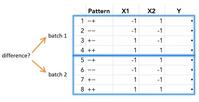

You can use a technique called blocking to minimize the impact of the variation caused by nuisance variables. For example, if you conduct the experiment across different batches, the individual batches might be different from one another.
Two batches of data showing eight experimental patterns with variables X1, X2, and response Y. Each batch includes all four combinations of X1 and X2 levels.
You can divide your experiment into blocks to balance the potential variation from the different batches across the runs in your experiment.
Experimental design table with variables Pattern, Block, X1, X2, and Y. Two batches are labeled as blocks to show how batch is used as a blocking variable in the experiment.
Additionally, if you are conducting your experiment across more than one day, uncontrolled day-to-day variation can add a lot of unexplained variation to your results. If you include Day as a blocking variable in your experiment, you can account for the day-to-day variation in your analysis so that you can better detect your important effects.

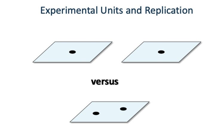

Let’s consider an experiment where you want to compare the hardness of four different types of drill bits by measuring the depth of indentations they make on metal sheets. The first few steps for this experiment might include the following tasks:
Replication occurs when you assign identical treatments to more than one experimental unit. An improper interpretation of replication is a repeated measurement.
Suppose you are limited to four experimental units for this experiment, thus allowing only a sample size of one for each of the four types of drill bit (the treatment). If you are concerned that this is insufficient, you might consider applying two treatments to each metal sheet and measuring the indentations. You reason that this gives you a sample size of two observations (or one replicate) for each treatment.
What's wrong with this approach?
True replication means applying the same treatment to more than one experimental unit. You cannot apply different treatments (drill bits) to an individual metal sheet, because the metal sheet is defined as a single experimental unit. By using each sheet twice, you perform pseudo-replication, not true replication. It's not appropriate to treat the two samples as independent, because the observations from the same metal sheet are interdependent.
