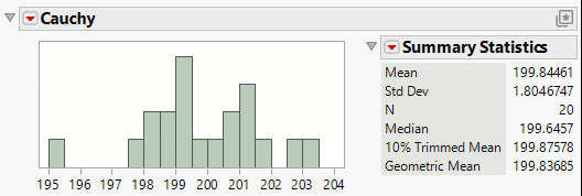

In the figure below, a histogram and summary statistics are shown for different samples from a heavy-tailed distribution coming from a population with a true center of 200. When there are extreme values in one tail, the sample mean is pulled towards that tail. The 10%-trimmed mean is more representative of the center of the data.
