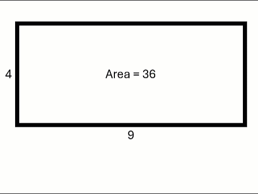

To calculate the geometric mean, multiply all the data values in your sample and take the nth root, where n is the number of observations you have. Let’s start with a simple example of just two numbers, say 4 and 9. The geometric mean is $\sqrt{4 \times 9} = \sqrt{36} = 6$.
The reason it’s called the geometric mean is that it has a geometric interpretation. A rectangle with side lengths 4 and 9 produces the same area as a square with side length 6.

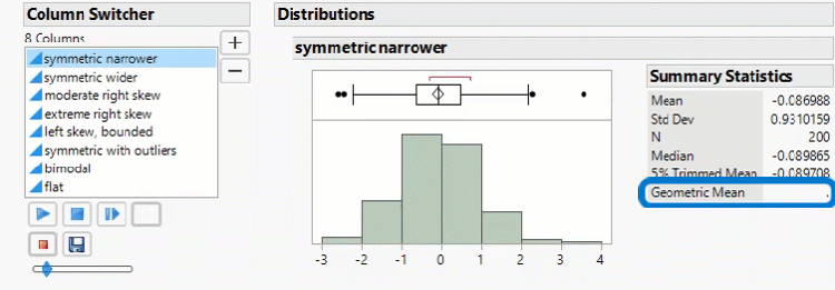

Examples of the mean
Examine the geometric mean for the data in the Univariate Statistics Data. You can compare the mean to the geometric mean. The geometric mean is always less than the arithmetic mean. The geometric mean is missing if the data contain negative numbers.
