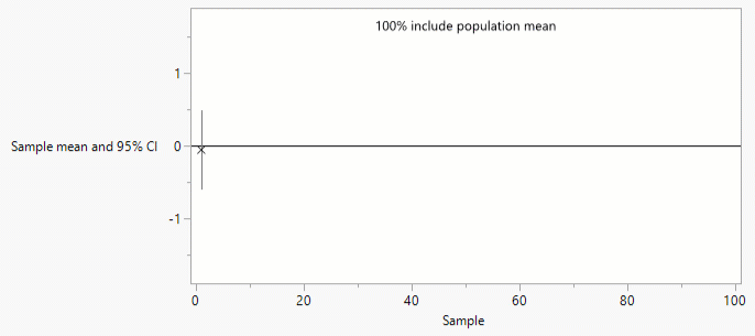

The animation below shows a thought experiment in which 100 samples are collected from a population where the mean is zero. For each sample, the 95% confidence interval is plotted. In most samples (95 out of 100, in fact) the confidence interval contains the true population mean, but in five samples it does not. In real life, you would not collect all these samples. This is simply a visual illustration of the interpretation of a confidence interval.

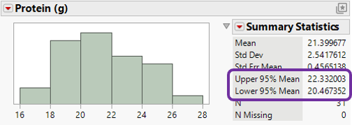

As an example, suppose you have measurements of the amount of protein in 31 energy bars (the data for this example can be found here). You believe the measurements come from one population. You want to estimate the mean of that population, so you calculate the sample mean and get 21.40 grams. You know the mean of the population isn’t exactly 21.40, so you calculate a 95% confidence interval for the mean. You find the standard deviation, s, of the sample to be 2.54. The standard error of the mean is:
$\frac{s}{\sqrt{n}} = \frac{2.54}{\sqrt{31}} = 0.46$
The sample mean of independent, normally distributed data has a t distribution, so you find the quantile of a t distribution with n – 1 = 30 degrees of freedom corresponding to a 95% confidence interval, which is 2.04. Using the formula, you calculate the confidence interval as
$\bar{y} \pm t_{n-1,\alpha/2} \frac{S}{\sqrt{n}} = 21.40 \pm 2.04 \cdot 2.54 / \sqrt{31} = (20.47,\;22.33).$
Statistical software allows you to plot the data and verify the calculation.

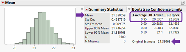

For example, let’s find a bootstrap confidence interval on the mean of our energy bar data. (Note that it is not necessary to use bootstrapping in this case. The theory is well-understood, and the data do not violate assumptions, but we will continue with this example for convenience.) You can use statistical software to resample from the data, each time calculating the mean of the resampled data.
The image below shows the histogram of the means of 2,500 bootstrap samples from the energy bar data, summary statistics for the bootstrap samples, and bootstrap confidence interval calculations for different levels of confidence.
The original estimate of the sample mean is 21.40. You can see in the Summary Statistics table above that the mean of the 2,500 bootstrap sample means is also 21.40. The 95% confidence interval on the mean of the population using the resampled data is (20.53, 22.30).
