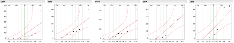

A normal quantile plot of the data for each furnace shows evidence of non-normality within each group. If the data were normally distributed, we would expect to see the points fall randomly above or below the red diagonal lines. Instead, the points are above the line at the left and right, and below the line in the center (C-shaped pattern). This pattern is consistent with skewed data, which makes sense for particle counts since they have a lower limit at zero.
