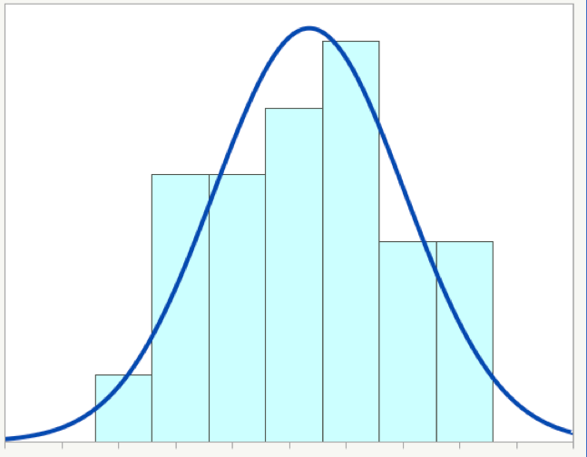

Figure 1 below shows a histogram for a set of sample data values along with a theoretical normal distribution (the curved blue line). The histogram is a type of bar chart that shows the frequency of data values. You can see that the data do not match up exactly with the curve, which is common. In fact, if you see data that exactly matches a theoretical normal distribution, you will want to ask a lot of questions. Real-life data rarely matches a distribution exactly.

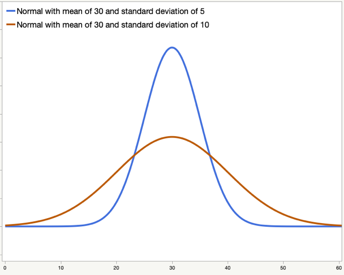

Figure 2 shows two normal distributions, each with the same mean of 30. The thinner, taller distribution shown in blue has a standard deviation of 5. The wider, shorter distribution shown in orange has a standard deviation of 10.

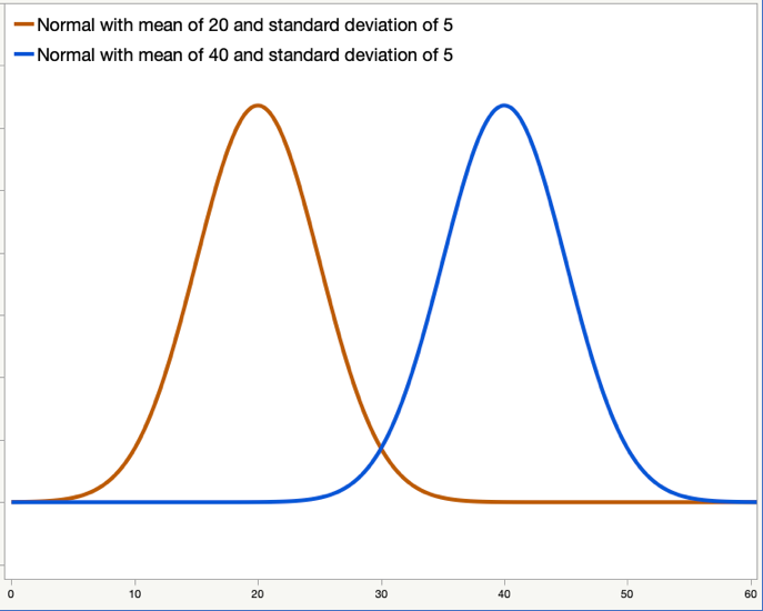

Figure 3 also shows two normal distributions, each with the same standard deviation of 5. The one on the left, shown in orange, has a mean of 20, while the one on the right, shown in blue, has a mean of 40.

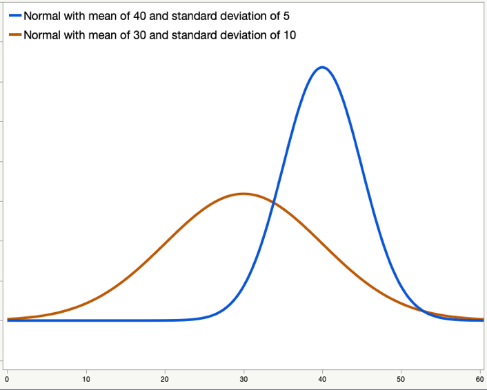

Figure 4 again shows two normal distributions. The distribution shown in orange has a mean of 30 and a standard deviation of 10. The distribution in blue has a mean of 40 and a standard deviation of 5.

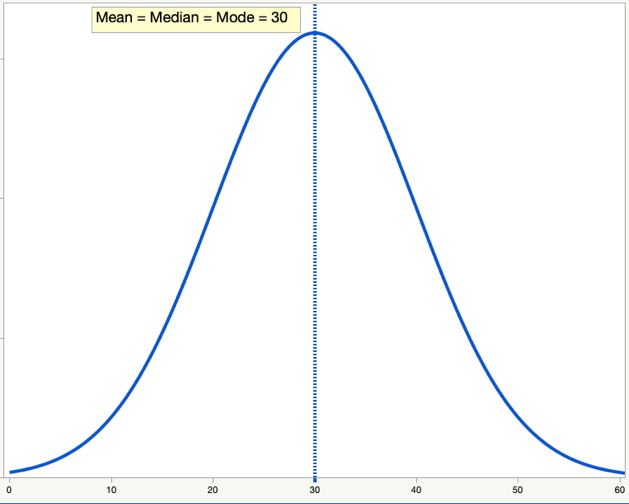

2. Mean = median = mode
The mean, median and mode are three ways to measure the center of a set of data values. For a true normal distribution, these three are identical. In practice, your data is likely to be nearly normal. The mean, median and mode are likely to be very close to each other, but not identical.
3. Symmetrical
The normal distribution is symmetrical. If you think about folding the graph in half at the mean, each side will be the same.

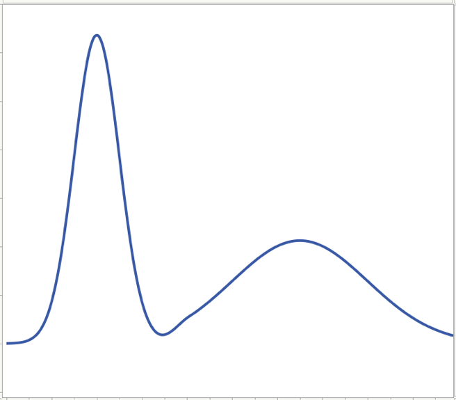

Figure 6 shows a distribution that is non-normal. It has two humps instead of one. A distribution with two humps could indicate that there are different groups that are mixed up in the data. For example, heart rates are usually normally distributed. But suppose, unknown to you, the data has the resting heart rate for two groups: athletes and inactive people. You might get a bimodal distribution like the one below.

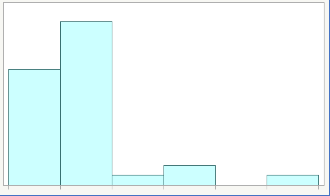

Figure 7 shows an example of a histogram for data that is not from a normal distribution.
When you look at a histogram as a visual check for normality, see if the chart:
- Has extreme values or not.
- Follows a symmetrical curve that is almost the same on both sides.
- Is bell-shaped or not.
As you can see, Figure 7 has extreme values, is not symmetrical and is not bell-shaped.

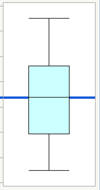

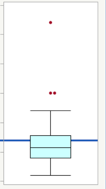

A box plot for a normal distribution shows that the mean is the same as the median. It also shows that the data has no extreme values. The data will be symmetrical.
Take a look at the two box plots in Figures 8 and 9 below. The data in Figure 8 is from a nearly normal distribution. The data in Figure 9 is from a non-normal distribution.
When you look at a box plot as a visual check for normality, see if the plot shows:
- Extreme values or not. The plot for the non-normal distribution in Figure 9 shows three outliers as red dots. The plot for the nearly normal distribution in Figure 8 shows no outliers.
- Symmetry or not. The plot for the nearly normal distribution (Figure 8) shows symmetry, while the plot for the non-normal distribution (Figure 9) does not.
- Mean and median nearly equal. In these box plots, the horizontal black center line in the box is the median, and the blue line is the mean. For the nearly normal distribution in Figure 8, the blue line for the mean is almost the same as the line in the middle of the box for the median.

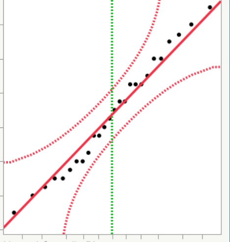

Figure 10 shows a normal quantile plot for data from a normal distribution. You can see how most of the data values fall near the solid red line. The data values also all fall within the dotted red confidence bounds.

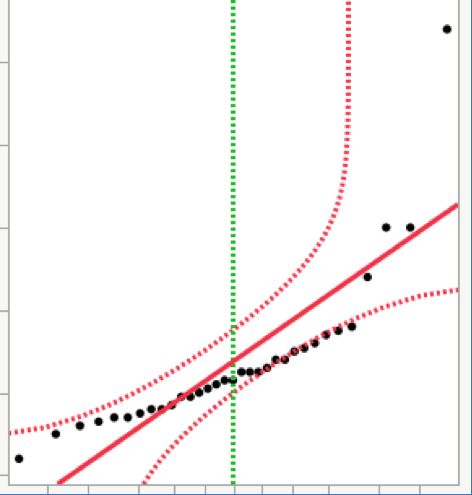

Figure 11 shows data that is not from a normal distribution. Some of the data values are near the solid red line, but most of them are not. Some of the data values are outside of the dotted red confidence bounds. There are also some extreme values in the upper right.
Most statistical software will create normal quantile plots. When you look at a normal quantile plot for normality, see if the data:
- Follows mostly along the line that shows the normal distribution.
- Falls within the confidence bounds most of the time.
