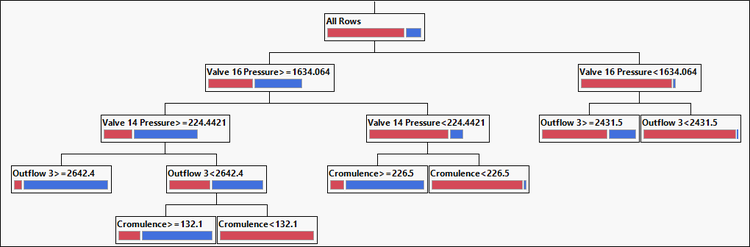

To build a decision tree, begin by splitting the observed data into two partitions, based on the value of one of the predictors. You find the predictor variable and the split value for this predictor by examining all possible predictors and sorted splits. The chosen predictor variable and split value is the one that results in the most dissimilar predicted probabilities for a categorical response or the most dissimilar predicted response for a continuous response.
Then you repeat the process. In all partitions, select a predictor variable and split value for this predictor that results in the biggest difference in predicted probabilities or mean response. You could continue the process until every split contained just one observation; that model, however, would overfit the data. Instead, you should fit the model on a training set and compare fit statistics on a validation set at each split in the tree. You might choose to stop when the next 10 splits do not produce an improvement in your chosen fit statistic, then prune the tree (combining splits together) back to the best fit statistic on the validation set.

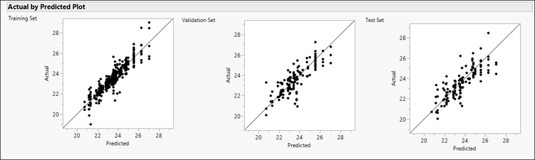

Let’s fit a decision tree model on the Recovery data we introduced in our overview of predictive modeling. We’ll look at the continuous response Percent Recovered.

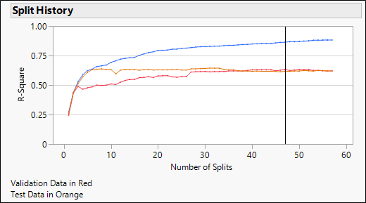

Without considering the validation set, the splitting procedure would finish with one observation in each terminal node of the tree, because R-square increases with model complexity. Instead, the procedure keeps splitting until no further improvement for R-square on the validation set is seen in the next 10 splits. The model is then pruned back (combining nodes together) to the point of maximum R-square.
Examination of the actual by predicted plot shows the discrete nature of the model. There are 47 splits in this model, so there are 48 predicted values of Percent Recovered.

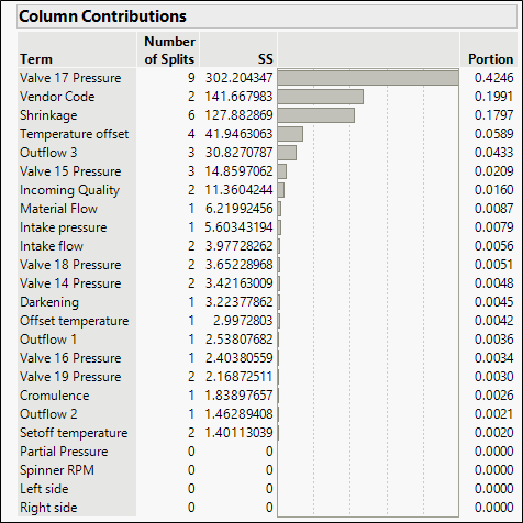

Random decision forests are not easy to interpret or explain, but you might not care about interpretation if prediction is your main goal of analysis. Random decision forests can be used for explanatory modeling or as a first step in building other predictive models. You can use a random decision forest model to find important predictors, then use just those chosen predictors in a linear model or neural network, for example.
