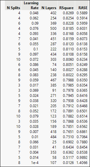

Latin hypercube tuning design for a boosted tree. A boosted tree was fit for each row in the table. The fit statistics on the validation set are displayed. The table has been sorted by decreasing R-Square.
The R-Square and RASE on the validation data are displayed. The best fit model has four splits per tree, a learning rate of 0.048, and 402 layers. R-Square on the validation set is 0.827. This run gives the best performance according to R-Square.

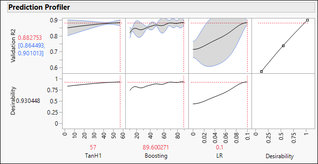

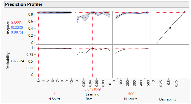

The beauty of designing an experiment is that we can fit a model to these 30 runs and use the model to predict settings of the hyperparameters to give best performance. Let’s fit a Gaussian process model to the experimental data.
The Prediction Profiler in JMP for Gaussian process model fit to the Latin hypercube space filling design data. The response is R-Square. The settings shown are those which are predicted to maximize R-Square on the validation set. A prediction of 0.8553 is made.
Next, let’s run a boosted tree using the predicted best values of the hyperparameters.

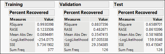

Fit statistics on tuned boosted tree model. R-Square on the validation set (0.833) is slightly higher than that of the best run from the space filling design (0.827).

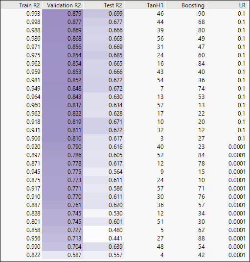

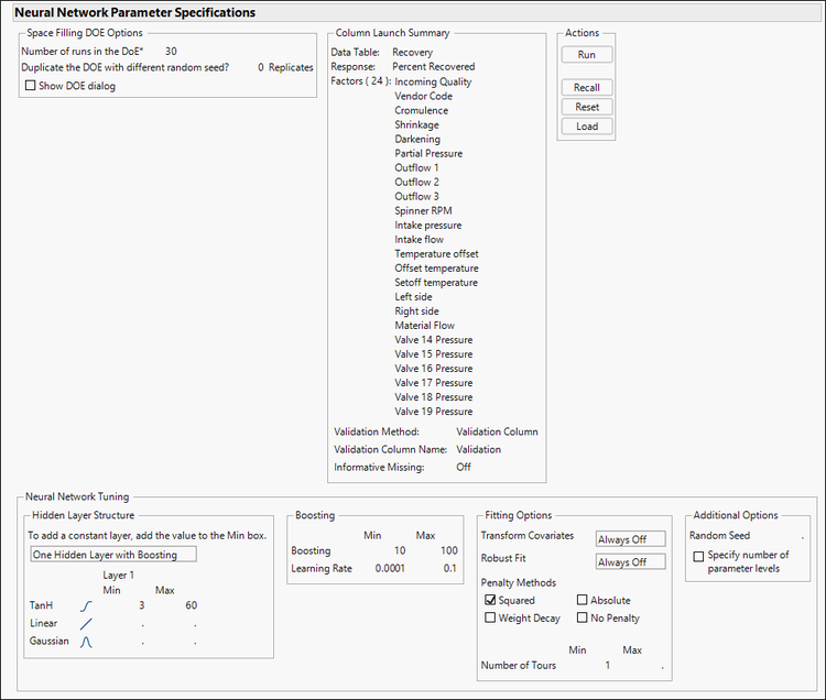

Let’s create a tuning table for a boosted neural model using the Percent Recovered response in the Recovery data. In this simple example, we’ll vary the number of TanH nodes, number of models in boosting, and the boosting learning rate. We make 30 runs.
Hyperparameter specification for tuning design for boosted neural network model.
Fast flexible space filling design for a boosted neural network. A boosted neural model was fit for each row in the table. The fit statistics on the validation holdout set are displayed. The table has been sorted by decreasing R-square.
You’ll notice that the best run has a validation R-square of 0.879. We can fit a model to these data using Validation R2 as a response then use the model to determine the best settings of the boosted neural hyperparameters.

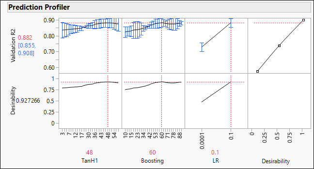

The Prediction Profiler in JMP for Gaussian process model fit to the fast flexible space filling design data. The response is Validation R2. The settings shown are those which are predicted to maximize R-Square on the validation set. A prediction of 0.882 is made.

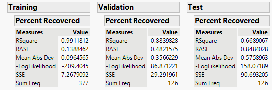

Next, let’s run a boosted neural network using the predicted best values of the hyperparameters.
Fit statistics on tuned boosted neural network model. R-Square on the validation set (0.884) is slightly higher than that of the best run from the space filling design (0.879).
