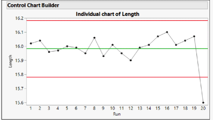

One widely used approach is statistical process control (SPC), which includes control charts. Started in industry to make sure that manufacturing processes were producing consistent product, control charts are used in other applications, including healthcare, laboratories, and even finance.
In our book printing example, control charts allow you to track performance and detect any unusual variation. As your company prints books, you measure your processes and use control charts to ensure the processes are stable over time.
Example of a control chart. Control limits are based on the natural variation of the data on the chart. Points within control limits are deemed part of the historical distribution, points outside the control limits are deemed to not belong to the historical distribution.

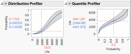

It is straightforward to decide if a product is fit for use at the time of manufacturing. But how can you determine if the product quality stays high or if it degrades over time? How can you determine expected failure times? These questions are answered with reliability analysis.
Reliability studies look at time-to-failure data to estimate quantities such as the average time to failure or the proportion of items that will fail within a certain timeframe. Reliability studies account for three different types of failure data: when failure times are known; when they are only known within a time interval; and when they have not yet been observed because the part hasn’t failed yet. Reliability analysis takes into account the partial information when exact failure times are not known. For example, you can collect data on whether the binding of a set of books has failed in order to predict failure times for one book, to compare the reliability of a new binding process to the old one, or for setting warranties.
The chart on the left shows that about 11.5% of items are predicted to fail by 1,825 hours. The chart on the right tells us that by about 3,641 hours, 50% of the items are predicted to fail. Other predictions can be made by changing the value of Life in the Distribution Profiler or Probability in the Quantile Profiler.
