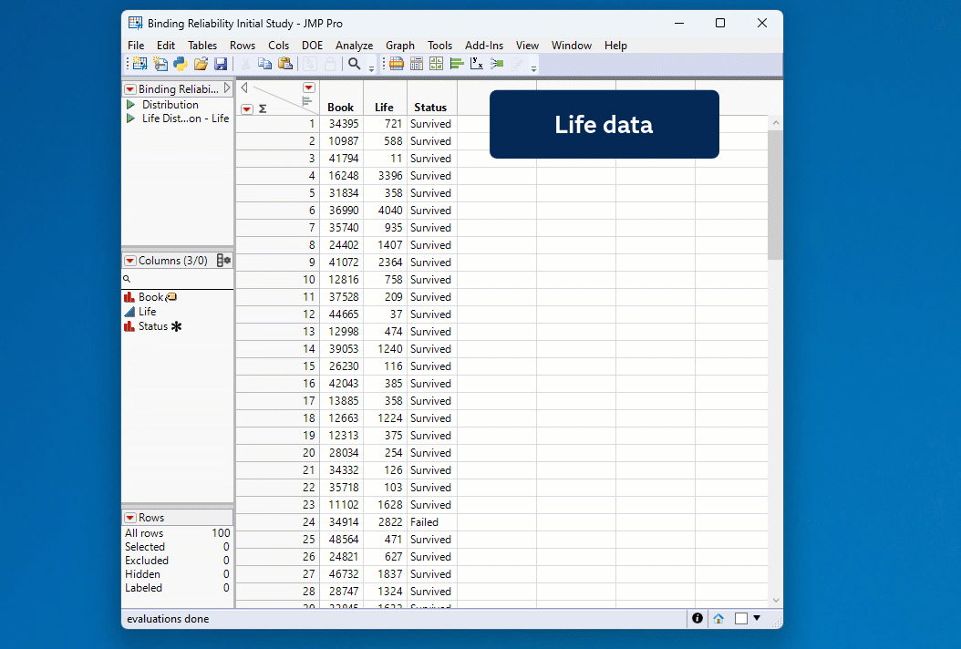

Learn how to find the Kaplan-Meier Estimates of Reliability in JMP.
https://www.youtube.com/watch?v=GMSv6vPZLMM
Figure 1: Details of Kaplan-Meier reliability estimates calculations
