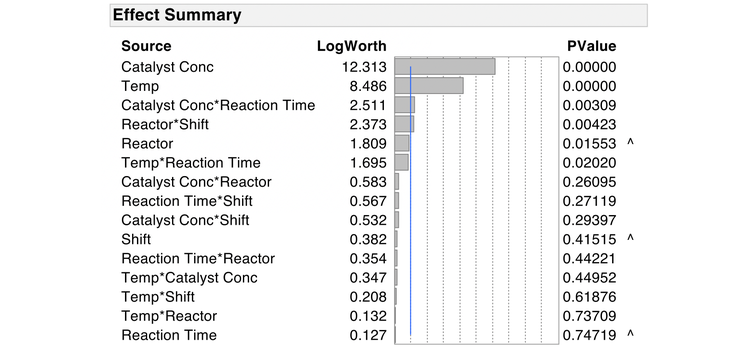

Let’s look at an example. For the Impurity data, we fit a full model with two-way interactions. Reaction Time has the highest p-value. However, the caret next to the p-value indicates that Reaction Time is involved in interactions in the model, so we leave it in the model. The next highest p-value is Temp*Reactor.
We remove this term and see that all the statistical output has updated, including the fit statistics and p-values for the model terms. The next candidate for removal is Temp*Catalyst Conc.
We remove this interaction term and continue this process until only terms with p-values below a chosen threshold remain. Here we stop removing terms when we hit the p-value threshold of 0.05. Stopping at a p-value of 0.05 is called a stopping rule, and the decision to stop at 0.05 was arbitrary. Typical stopping rules for explanatory modeling are p-value thresholds of 0.05 and 0.10. Note that there are other stopping rules we might consider. For example, we might stop at the model that has the highest RSquare Adjusted or the lowest Root Mean Square Error. Later, we introduce two other important statistics for model selection: Akaike information criterion (or AIC) and the Bayesian information criterion (or BIC).

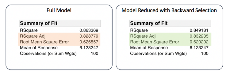

Let’s compare the fit of the full model against this new reduced model. Both RSquare Adjusted and Root Mean Square Error are improved over the full model. So, this reduced model is better.

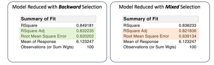

The mixed approach addresses a fundamental drawback of forward selection: terms might become insignificant after other terms have been added to the model. Mixed selection allows nonsignificant terms to be removed. In this example, mixed selection results in a smaller model than backward selection. But, if we compare these two models, RSquare Adjusted is lower and Root Mean Square Error is higher for the mixed model. So, the backward selection model outperforms the mixed selection model.
