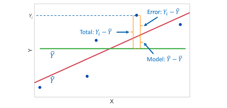

The total variation in our response values can be broken down into two components: the variation explained by our model and the unexplained variation or noise (Figure 1 below).

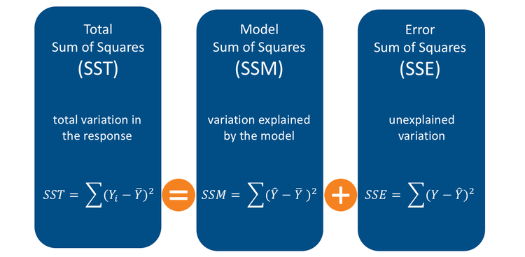

As shown in Figure 2:
  • The total sum of squares, or SST, is a measure of the variation of each response value around the mean of the response. For each observation, this is the difference between the response value and the overall mean response.
  • The model sum of squares, or SSM, is a measure of the variation explained by our model. For each observation, this is the difference between the predicted value and the overall mean response. This is the variation that we attribute to the relationship between X and Y. Note that sometimes this is reported as SSR, or regression sum of squares.
  • The error sum of squares, or SSE, is a measure of the random error, or the unexplained variation. For each observation, this is the difference between the response value and the predicted value. This is the variation that is not explained by our regression model. This is also referred to as sum of squared errors.

Figure 1: Total variation consists of variation explained by the model and unexplained variation (noise or error)
All of the variation in our response can be broken down into either model sum of squares or error sum of squares.
Figure 2: Total sum of squares = model sum of squares + error sum of squares

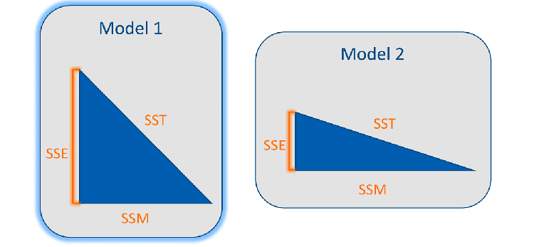

Another way to think about sums of squares is to consider a right triangle. The total sum of squares can be broken down into error and model sums of squares. Compare the sums of squares for Model 1 and Model 2. In Model 1, more of the total variation in the response is unexplained (SSE) than in Model 2. In other words, Model 2 explains more of the total variation in the response than Model 1.
Figure 3: In Model 2, model sum of squares (SSM) explains more of the total variation

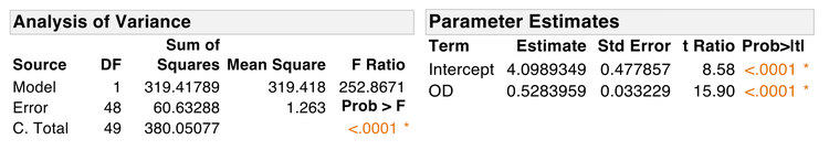

The sums of squares are reported in the Analysis of Variance (ANOVA) table (Figure 4). In the context of regression, the p-value reported in this table (Prob > F) gives us an overall test for the significance of our model. The p-value is used to test the hypothesis that there is no relationship between the predictor and the response. Or, stated differently, the p-value is used to test the hypothesis that the true slope coefficient is zero.
For the cleaning example, we fit a model for Removal versus OD. Because our p-value is very small (<.0001), we can conclude that there is a significant linear relationship between Removal and OD.
Figure 4: ANOVA table and Parameter Estimates table
In a simple linear regression situation, the ANOVA test is equivalent to the t test reported in the Parameter Estimates table for the predictor. The estimates in the Parameter Estimates table above are the coefficients in our fitted model. As we have discussed, we can use this model directly to make predictions.
Removal = 4.0989349 + 0.5283959*OD

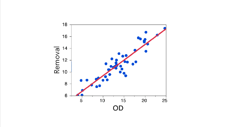

More specifically, we can use the model to predict average Removal within the range of values we observed for OD. This is an important point. The OD values in our sample range from 4 to 24.7. It's important to keep in mind that extrapolating beyond this range can lead to unrealistic or unreliable predictions.
Figure 5: Extrapolating beyond the observed range of values can lead to unreliable predictions

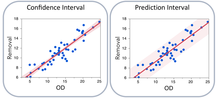

We can also construct two types of intervals using our model: confidence intervals and prediction intervals (Figure 6).  Confidence intervals, which are displayed as confidence curves, provide a range of values for the predicted mean for a given value of the predictor. The shaded bands represent the uncertainty in the estimates of the true line.
Figure 6: Confidence intervals and prediction intervals
Prediction intervals provide a range of values where we can expect future observations to fall for a given value of the predictor. Prediction intervals are useful when we are interested in using the model to predict individual values of the response.

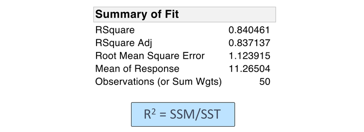

One popular statistic is RSquare, the coefficient of determination. RSquare provides a measure of the strength of the linear relationship between the response and the predictor. In simple linear regression, RSquare is the square of the correlation coefficient, r.
This statistic, which falls between 0 and 1, measures the proportion of the total variation explained by the model.
Figure 8: Additional measures of the fit of the model
The closer RSquare is to 1, the more variation that is explained by the model. In our example, 84.8584% of the variation in our response, Removal, is explained by the variable OD.
Note that the value of RSquare can be influenced by a number of factors, so here are a few cautions:
So, although RSquare is a useful measure, and in general a higher RSquare value is better, there is no cutoff value to use for RSquare that indicates we have a good model. RSquare, and the similar measure RSquare Adjusted, are best used to compare different models on the same data. We describe RSquare Adjusted in the Multiple Linear Regression lesson.
