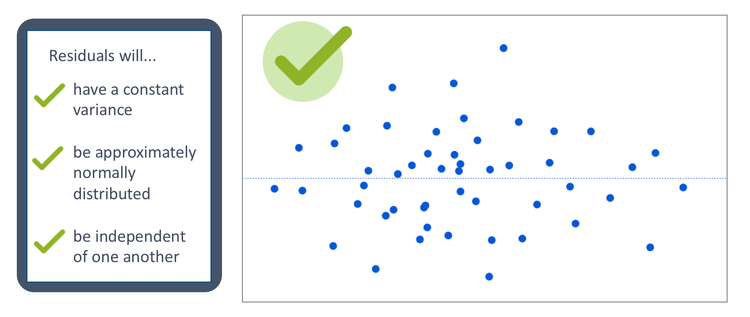

How do we check regression assumptions? We examine the variability left over after we fit the regression line. We simply graph the residuals and look for any unusual patterns.
If a linear model makes sense, the residuals will
- have a constant variance
- be approximately normally distributed (with a mean of zero), and
- be independent of one another.
The most useful graph for analyzing residuals is a residual by predicted plot. This is a graph of each residual value plotted against the corresponding predicted value.
If the assumptions are met, the residuals will be randomly scattered around the center line of zero, with no obvious pattern. The residuals will look like an unstructured cloud of points, centered at zero.

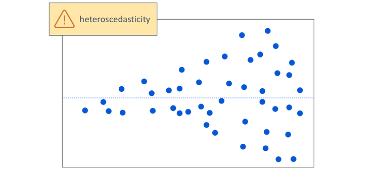

If the residuals fan out as the predicted values increase, then we have what is known as heteroscedasticity. This means that the variability in the response is changing as the predicted value increases.
This is a problem, in part, because the observations with larger errors will have more pull or influence on the fitted model.

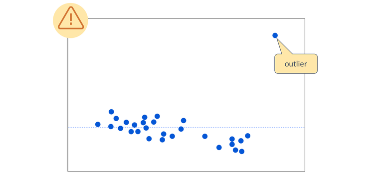

An unusual pattern might also be caused by an outlier. Outliers can have a big influence on the fit of the regression line.
In this example, we have one obvious outlier. Many of the residuals with lower predicted values are positive (these are above the center line of zero), whereas many of the residuals for higher predicted values are negative.
The one extreme outlier is essentially tilting the regression line. As a result, the model will not predict well for many of the observations.

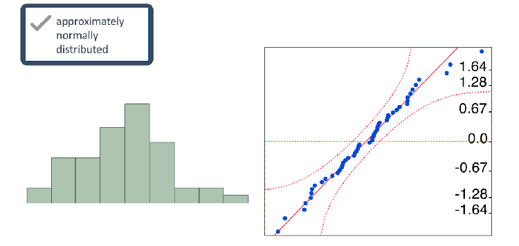

In addition to the residual versus predicted plot, there are other residual plots we can use to check regression assumptions. A histogram of residuals and a normal probability plot of residuals can be used to evaluate whether our residuals are approximately normally distributed. However, unless the residuals are far from normal or have an obvious pattern, we generally don’t need to be overly concerned about normality.
Note that we check the residuals for normality. We don’t need to check for normality of the raw data. Our response and predictor variables do not need to be normally distributed in order to fit a linear regression model.
