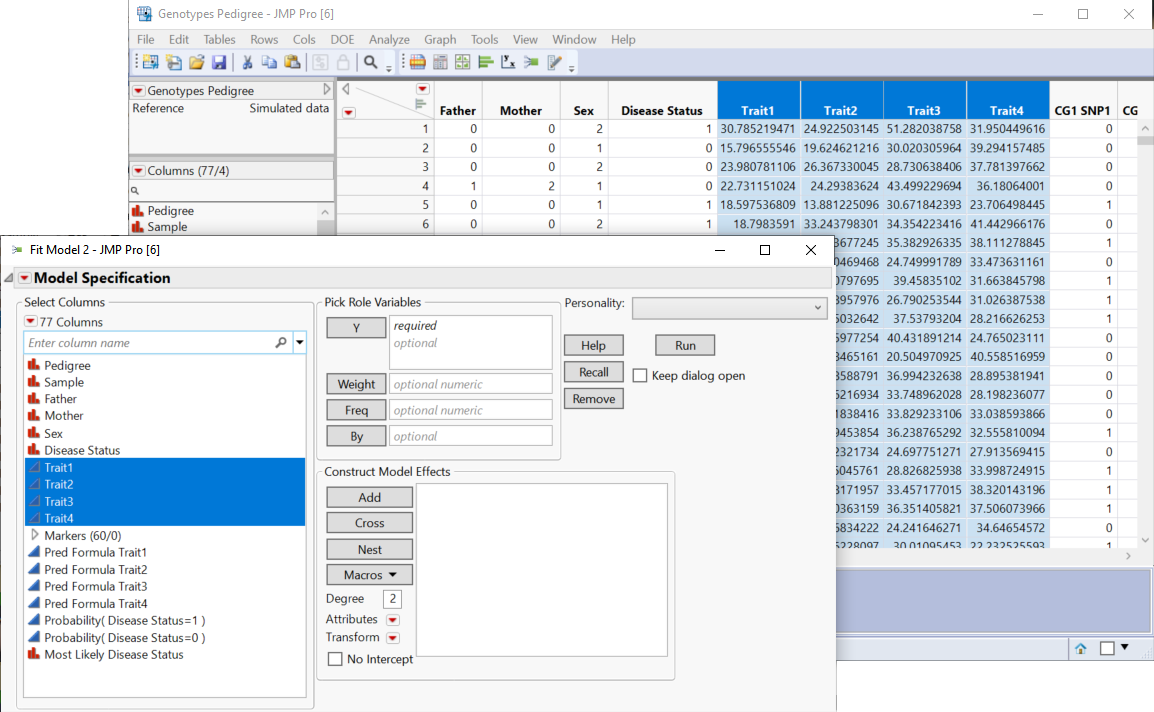

| 8 | Select one or more of the trait columns (Trait1 - Trait4). |
| 8 | Select Analyze > Fit Model. |

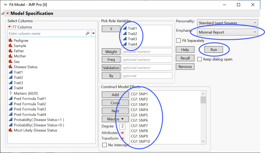

| 8 | Specify the Trait variables as the Y variables. |
| 8 | Select the Markers group and add it to the Model Effects field. |
| 8 | Click the Emphasis drop-down menu and select Minimal Report. |
The complete launch window is shown below:
| 8 | Click to generate the predictor formulas. |

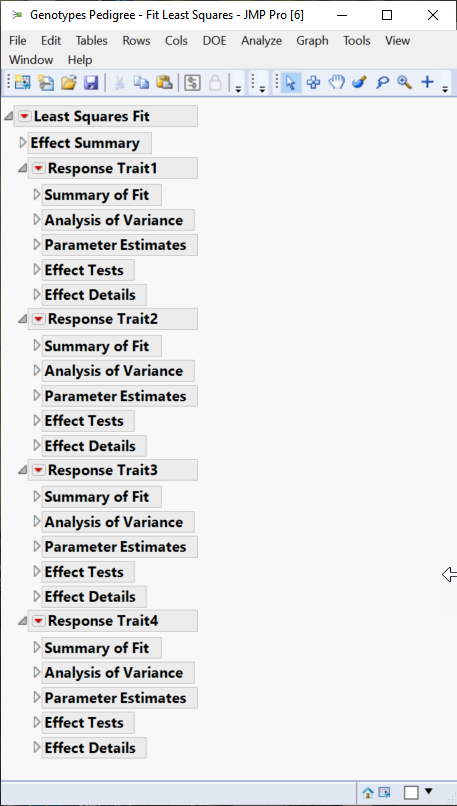

The Fit Model report is shown below:
| 8 | Click the Response Trait1 and select Save Columns > Prediction Formula to save a column of formulas to the data table. |
| 8 | Repeat for Response Trait2, Response Trait3, and Response Trait4. |

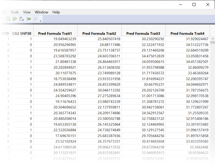

Four columns of predictors are added to the end of the data table.

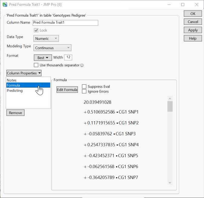

| 8 | To see the formulas, right-click on the column name and select Column Info... |
| 8 | Click Formula in the Column Properties field. |
