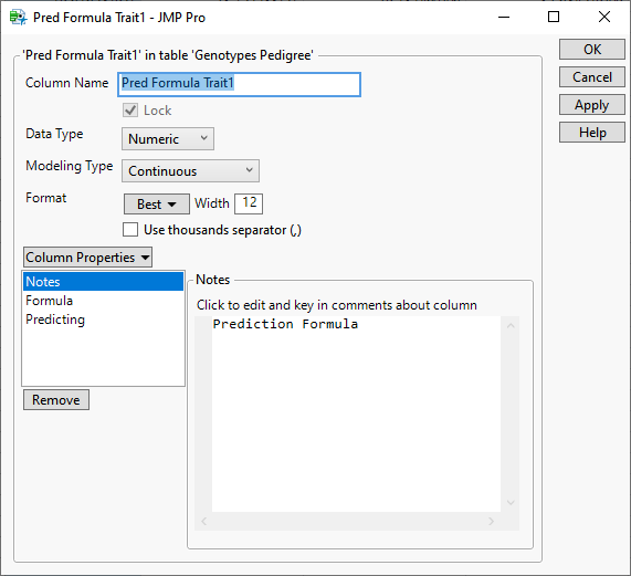

| 8 | Right-click on the corresponding predictor formulas column name and select Column Info... |

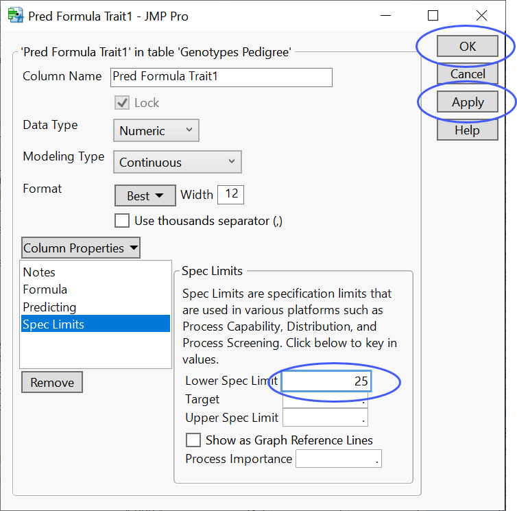

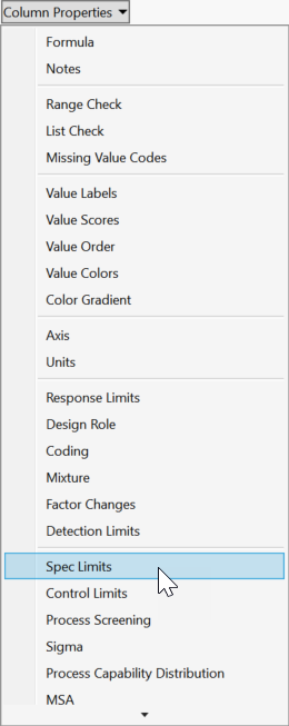

| 8 | Click the Column Properties drop-down menu and select Spec Limits. |
| 8 | Enter the Lower limit, upper limit, and/or target value in the appropriate space and click and then . |
| 8 | Verify the limit by right-clicking the column name and selecting Column Info.... The specification limit should appear in the Column Properties field. |
