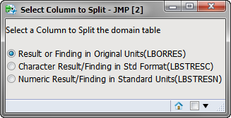

| 8 | Click to split the output data. |
A JMP appears (shown below).

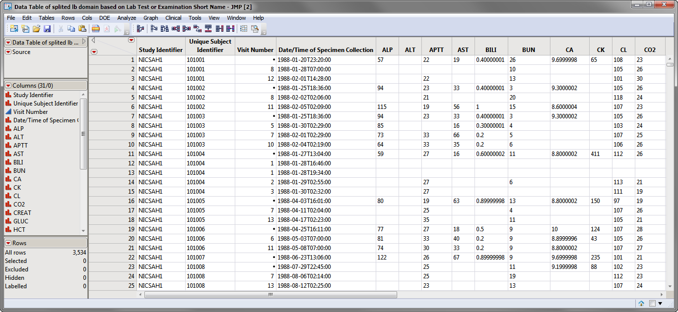

| 8 | Use the radio buttons to select the column to split the data by. |
A data table (shown below) with the subjects as rows and individual tests as columns is generated.
