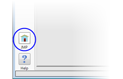

A JMP Home button (
) is added to the JMP Clinical Main , as shown below:

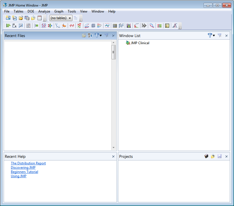

Accessing JMP:
| 8 | Click the icon to open the JMP Home (shown below). |
Use the Help menu to access the JMP Help system for documentation, tutorials, and other information about using JMP.
