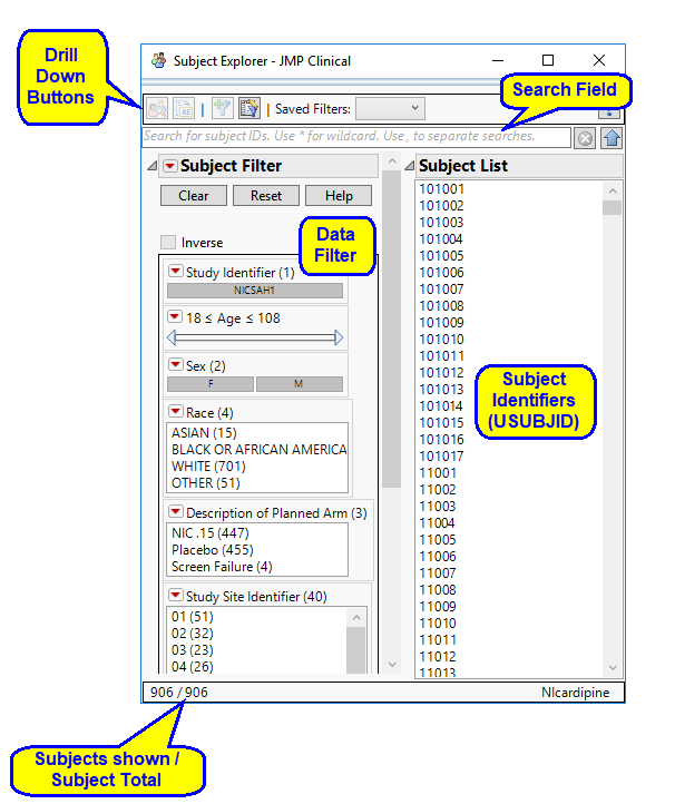

Use the Data Filter to select specify criteria for including subjects to explore. Only those subjects meeting the filtering criteria are shown in the subject list. |
8
Click to select a subject and use drill down buttons for further analysis. Use Ctrl-click to select multiple subjects. Alternatively, you can enter specific USBJIDs in the Search Field and these will automatically be listed in the selectable window. |
8
Click to generate patient profiles of the selected subjects. |
8
Click to create a subject-specific filter that is applied to all subsequent reports run on the data for the study. Only those patients specified by the filter are carried through the analyses. |
8
Use the drop-down menu to select existing filters for your analyses. |
