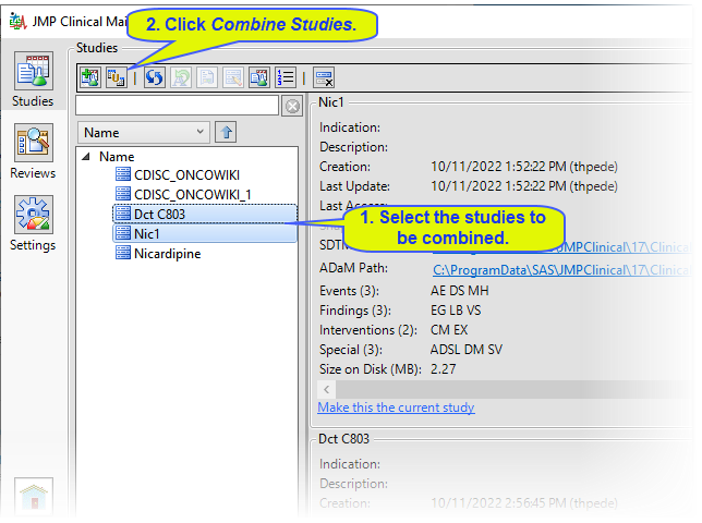

To combine two studies:
8 Select the two studies to be combined and click .

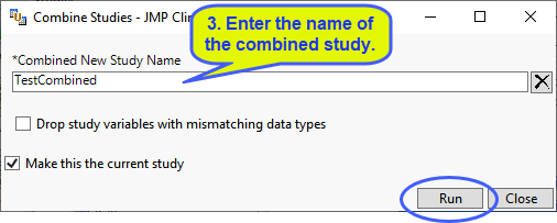

8 Specify the names of the new study and the SDTM and ADaM folders and click .
Links to specific documentation for each of the options are provided in the following table:
Options
Information
Combined New Study Name
The study name must conform to the Rules for Study Names.
Drop study variables with mismatching data types
Select this option to exclude study variables with different data types (numeric vs. character) from the combined study.
Make this the current study
Checking this box makes your study the default study for all reports. This option is checked by default.
8 Specify the desired options and click .

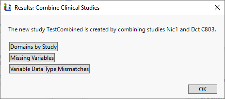

When the combination process is complete, the following Results window appears.
You can choose among the options to view selected items in the combined study.

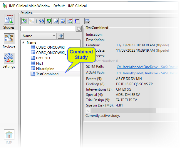

The combined study has been added to the list of available studies.
Note: Combined studies cannot be refreshed. You should refresh the initial studies individually and combine them again.
