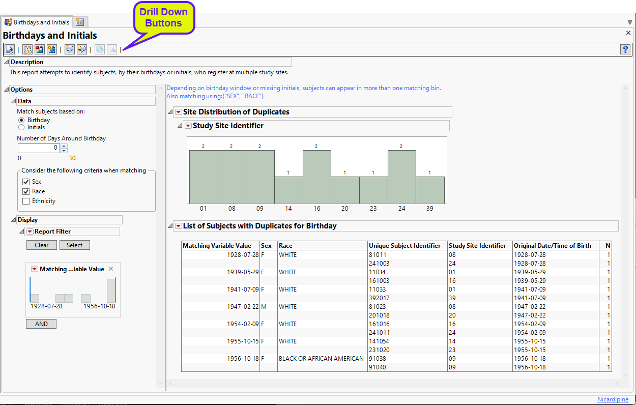

This report attempts to identify subjects, by their birthdays or initials, who register at multiple study sites.
Report Results Description
Running this report with the Nicardipine sample setting and default options generates the output shown below.
This section contains the following:
| • | One Distribution. |
This Distribution shows the numbers of pairs of subjects sharing the same birth date/initials by the sites at which they occur.
| • | One Table. |
This table lists any birth dates where two or more subjects match. Supporting information (if available) to determine whether multiple Unique Subject Identifiers refers to the same person include Study Site Identifier, Date of Birth, Sex, Race, Ethnicity, Height, Weight, and Initials.
See Tabulate for more information.
If the report is run matching on initials, the Matching Variable Value reflects Initials. Here, the section is named List of Subjects with Duplicates for Initials.

Use these options to specify matching criteria for identifying duplicate subjects based on demographic information.
Match subjects based on:
By default, this report attempts to Match subjects based on: their date of birth. You can optionally match subjects by their initials instead.
Number of Days Around Birthday
Increasing the Number of Days around Birthday that are included in the search can increase the chances of finding matches.
Consider the following criteria when matching
Adding or subtracting Sex, Race, and/or Country to your search criteria increases or decreases, respectively, the specificity of your search.
