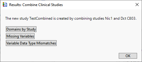

When the combination process is complete, the following Results window appears.
You can choose among the options to view selected items in the combined study.
The combined study has been added to the list of available studies.
