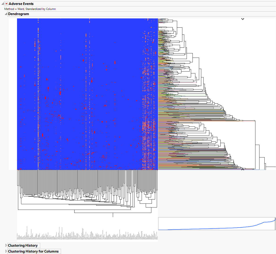

The AE Indicators section is shown below:
An Indicator section contains the following elements:
• A two-way hierarchical clustering analysis of the 0-1 variables, with subjects as rows and indicator variables as columns.
You can study the Heat Map and Dendrogram to see both subjects that have similar values of the binary variables as well as binary variables that are similar across subjects.
See the JMP Hierarchical Clustering platform for more information.
