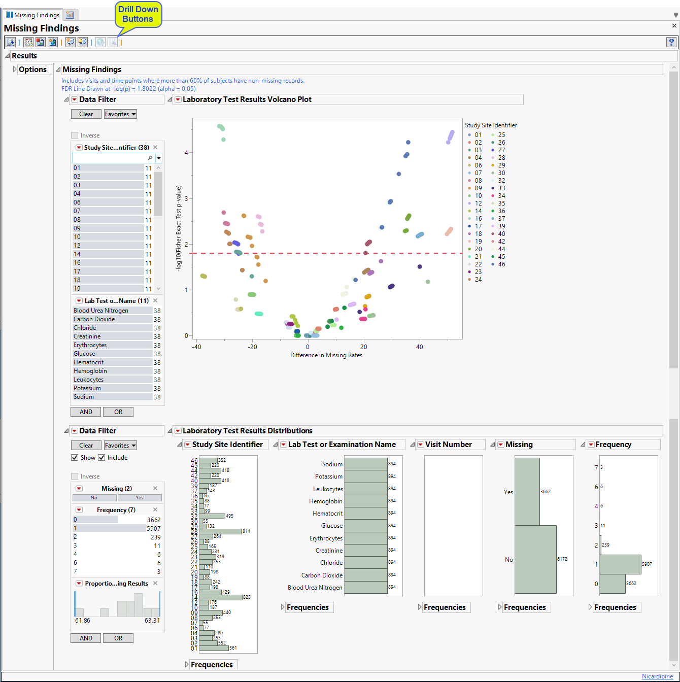

Running Missing Findings for the Nicardipine study with the threshold for subjects expected set to 60% generates the report shown below:
This report contains the following elements:

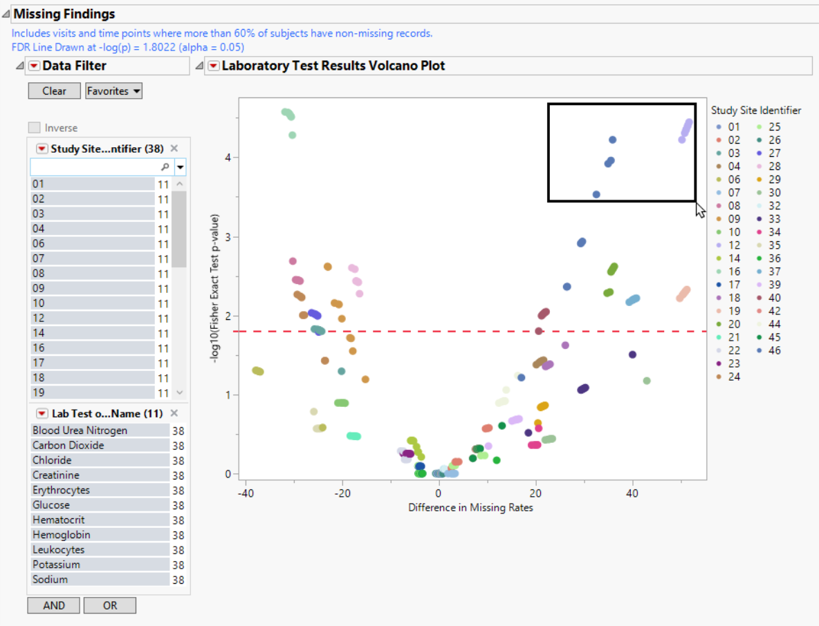

Missing Findings Volcano Plot
Shows a volcano plot used to determine the deviation of the proportion of missing fundings results at each study site with the overall proportions for the whole study.
• One Data Filter.
Enables you to subset subjects based on study site and/or Test, or additional variables. Refer to Data Filter for more information.
• One Volcano Plot.
The volcano plot is used to determine the deviation of the proportion of missing fundings results at each study site with the overall proportions for the whole study. Each point represents the results for one type of findings test at one site. Those tests/sites plotting close to 0 on both axes show little or no difference from the averages across the entire study. Those tests/sites plotting more distally show greater differences in number of missing findings from the averages.
You can mouse over points of interest to see their labels or select points by dragging a mouse rectangle over them (as shown above). Selected Findings tests are highlighted in other plots and you can also then click on various Drill Down Buttons for further analyses on those specific sites.
See Volcano Plot for more information.

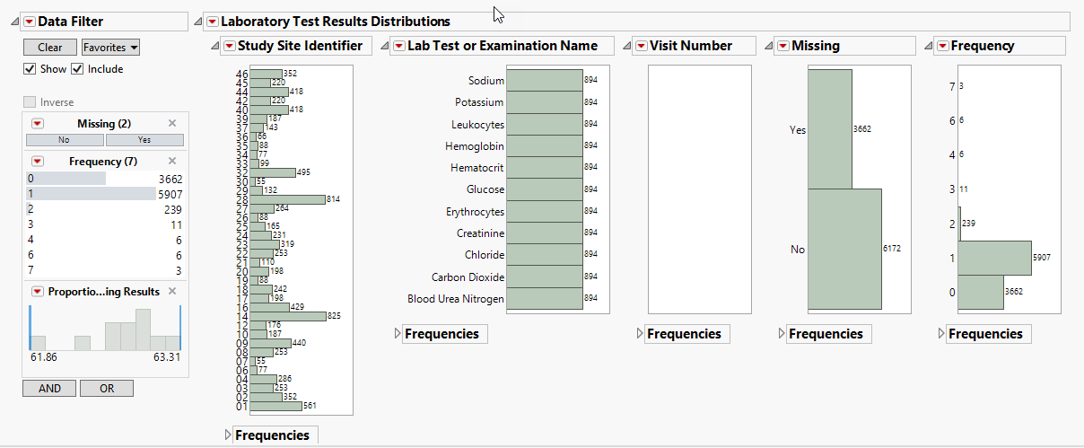

Distributions
This section contains the following elements.
• Data Filter: Enables you to filter data based on study site and country.
• Distributions: Displays histograms showing distribution of selected domain findings across study sites, tests, and visit numbers,
Laboratory Test Results
Displays histograms showing distribution of laboratory test findings across study sites, tests, and visit numbers, as well as the frequencies of records with either available or missing results.

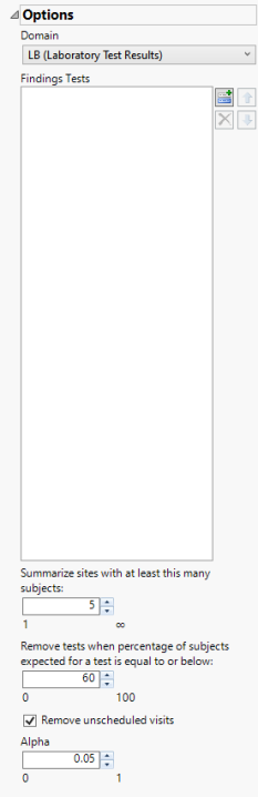

Options
Domain
Use this widget to specify whether to plot the distribution of measurements from either the Electrocardiogram (EG), Laboratory (LB), or Vital Signs (VS) findings domains.
Findings Tests
By default the report is set to analyze all tests from all findings domains. You can opt however, to restrict the search to specific Findings Tests.
Summarize sites with at least this many subjects:
The Summarize sites with at least this many subjects: option enables you to set a minimal threshold for the sites to be analyzed. Only those sites which exceed the specified number of subjects are included. This feature is useful because it enables you to exclude smaller sites, where small differences due to random events are more likely to appear more significant than they truly are. In larger sites, observed differences from expected attendance due to random events are more likely to be significant because any deviations due to random events are less likely to be observed.
Remove tests when percentage of subjects expected for a test is equal to or below:
By default, findings analyses are conducted assuming that sufficient numbers of subjects have participated to make the results statistically significant. As a result, all test results, including missing results, are included in findings analyses. However, findings can be skewed when the percentage of missing results is greater than expected. For these cases, you should use the Remove tests when percentage of subjects expected for a test is equal to or below: option to specify a minimal participation threshold. Tests not meeting this threshold are excluded from the analysis.
Remove unscheduled visits
By default, all patient visits are included in the analysis. The Remove unscheduled visits option enables you to restrict the analysis to scheduled visits only.
Alpha
The Alpha option is used to specify the significance level by which to judge the validity of the missing findings data generated by this report. The meaning of alpha depends on the adjustment method that you select. Alpha can be set to any number between 0 and 1, but is most typically set at 0.001, 0.01, 0.05, or 0.10. The higher the alpha, the higher the error rate but also higher the power for detecting significant differences. You will need to decide on the best trade-off for your experiment.
Action buttons, provide you with an easy way to drill down into your data. The following action buttons are generated by this report:
• Click to rerun the report using default settings.
• Click to view the associated data tables. Refer to Show Tables/View Data for more information.
• Click to generate a standardized pdf- or rtf-formatted report containing the plots and charts of selected sections.
• Click to generate a JMP Live report. Refer to Create Live Report for more information.
• Click to take notes, and store them in a central location. Refer to Add Notes for more information.
• Click to read user-generated notes. Refer to View Notes for more information.
• Click to open and view the Review Subject Filter.
• Click to specify Derived Population Flags that enable you to divided the subject population into two distinct groups based on whether they meet very specific criteria.
