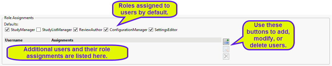

One of the key components of the system.clinical.preferences file is the specification of user role assignments. A user role defines the level of functional interactivity that a user has in JMP Clinical. The following user roles can be set for individual users.
• Study Manager - A user with this role can do all of the operations involved in managing studies within JMP Clinical: add, combine, and refresh metadata, rename or move folders, update a review with a new snapshot, update the study risk data set, and delete studies. The code specification for this role is "StudyManager".
• Study List Manager - A user with this role can manage and delete studies from shared folders. By default, this role is not assigned. The code specification for this role is "StudyListManager".
• Review Author - A user with this role can create/edit/save Review Templates, do ad hoc analyses, and create and save Reviews. They can also manage the Holiday and Event data set and Risk Threshold data sets used by the configuration. A Review Author implicitly has the Reviewer role as well. The code specification for this role is "ReviewerAuthor".
• Reviewer - A user with this role can open Reviews. The code specification for this role is "Reviewer".
• Configuration Manager - A user with this role can add and define JMP Clinical configurations. This role is assigned to all users by default. The code specification for this role is "ConfigurationManager".
• Settings Editor - A user with this role has access to the Settings tab on the JMP Clinical Main Window. This enables them to select different configurations (if defined), and change how they view Documentation and Help. The code specification for this role is "SettingsEditor".
Important Note: We generally do not recommend restricting the "SettingsEditor" rights from users. This should be done only if you want to severely restrict the use of the system for that user such that they are not able to select configurations.
By default, all users are assigned all roles except Study List Manager. System administrators, however, can restrict individual users to specific user roles using the following procedures. See Adding Users and Specifying Role Assignments for information about specifying user roles.

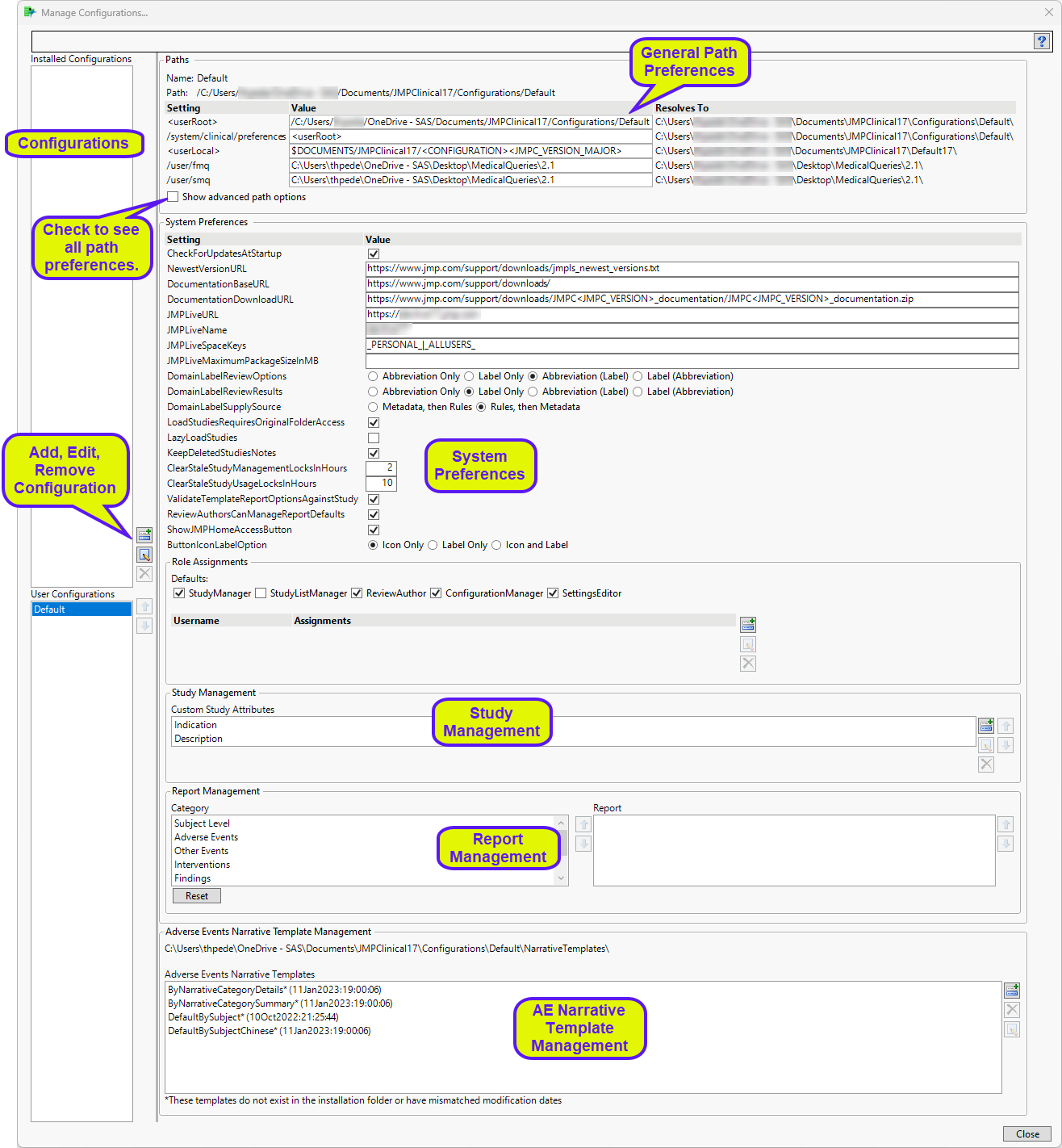

The Manage Configurations... Window
The Manage Configurations... window is accessed from the Settings tab of the JMP Clinical Main Window.
8 Click to open the Manage Configurations... window, shown below:

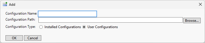

8 Click to open the Add window shown below:

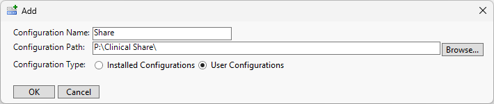

8 Specify a name for your configuration.
In this case, the configuration is named Share.
8 Click to open a Choose Directory window.
8 Navigate into the Clinical Share folder and click .
8 Click the User Configurations radio button.
The Add window appears as shown below:
8 Click .
The new configuration is added to the Manage Configurations window. If you select it, all of the default paths and system preferences are displayed, as shown below:
Note: While all paths and preferences are editable, you should consult your system administrator before making any changes.

System Preferences
System preferences enable you to set preferred behaviors for JMP Clinical. Options include automatic checking for updates specifying how domains and buttons are identified on the user interface, which dates and snapshots to honor when comparing studies, and so on. Use the available controls to customize your installation of JMP Clinical.
See the tables below for descriptions of each option:

Role Assignments
By default, a JMP Clinical installation is fully functional with all reports and options available to you. However, the JMP Clinical installed on your machine, might be configured for a specific user role. These roles are set as described in Adding Users and Specifying Role Assignments.
What follows here is a brief description of each of the JMP Clinical user roles and how to specify roles for each user.
Study Manager
Study List Manager
A user with this role can remove studies from shared locations. This option is not enabled, by default.
This option is important in the following scenario: a user completes an analysis of a study, deletes the study from the local install of JMP Clinical, and then deletes the study data files from a shared location. Unfortunately, this process does not delete the study name from the shared metadata file. It still appears in other users’ JMP Clinical installations but cannot be accessed. The study name also remains unavailable and cannot be used again. A Study List Manager can remove the study by the following:
8 Click the Studies tab.
8 Click the Name drop-down menu and select Unlisted (no access).
8 Highlight the study to be deleted and click .
Review Author
A user with this role can create/edit/save Review Templates, do ad hoc analyses, and create and save Reviews. They can also manage the Holiday and JMP Life Sciences / SAS Institute Event data set and Risk Threshold data sets used by the configuration. A Review Author implicitly has the Reviewer role as well.
A user with this role can create/edit/save configurations. alterable features include file paths, system preferences, role assignments, and order of report sections.
Settings Editor
This role is normally found in conjunction with one or more of the other user roles. A user with this role has access to the Settings tab on the Main Clinical window. This enables them to select different configurations (if defined), change how they view Documentation and Help, and download and install a local copy of the documentation.
Use the Role Assignments options to define roles for additional users,
In this example user anisco is assigned all user roles. User CARYNT\sasajfhas all roles except Study manager.
Note: CARYNT\sasajf actually designates both the user name (sasajf) and the network domain (CARYNT) to which the user belongs. This ability to define both the domain and user gives the system administrator flexibility in identifying individual users.
To add a user:
8 Click to open the Add window.
8 Enter the user’s domain (if needed) and Windows user name in the text box.
8 By default, the new user has all of the roles checked under Defaults.
8 Check the appropriate boxes to Grant the new user a role not already checked in Defaults.
8 Check the appropriate boxes to Revoke from the new user a role that is checked in Defaults.
8 Click to add the user.
To edit a user’s role assignments:
8 Select an existing user.
8 Click to open the Edit window.
8 Check the appropriate boxes to Grant the user one or more additional roles.
8 Check the appropriate boxes to Revoke from the user one or more assigned roles.
8 Click to save the changes.
To delete a user:
8 Click to delete the user.

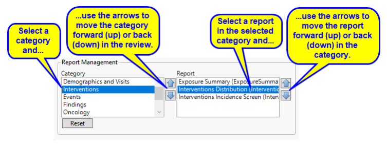

Report Management
The Report Management option enables you to specify the order in which the report categories and the reports themselves are presented in the review.

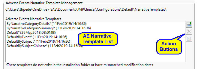

Adverse Events Narrative Template Management
The Adverse Events Narrative Template Management option enables users to add/remove selected templates that are available for the selected configuration. Configurations shared among users are immediately impacted by changes made to the list of available templates.
The Adverse Events Narrative Templates section lists all of the templates currently in the selected configuration. The templates are listed by their names (name of the base VM file) and the date/time of the last modification. You can add, remove, or edit templates using the action buttons.
The button is enabled if there are templates that are in the JMPC installation location (as per the installation.path.preferences file) that are NOT in the configuration's template location (also per the the installation.path.preferences). Note that existence is based on name and modification date/time. That is, a template may appear to be in the configuration and the install (have the same name), but if the modification date/times don't match, it is available for adding. In the cases where there isn't a match between the configuration and installation, the template is marked with a trailing asterisk (*).
The button is used to remove a template from the configuration. In the cases where these isn't a template match, a warning is issued that the selected template cannot be recovered once deleted. This is to handle the cases where a configuration has templates that were added outside of the installation.
Finally, the button attempts to launch (open) the .VM files that comprise the selected template. This is simply delegating the edit action to the OS. The editing program selected depends on you machine's operating system preferences.
