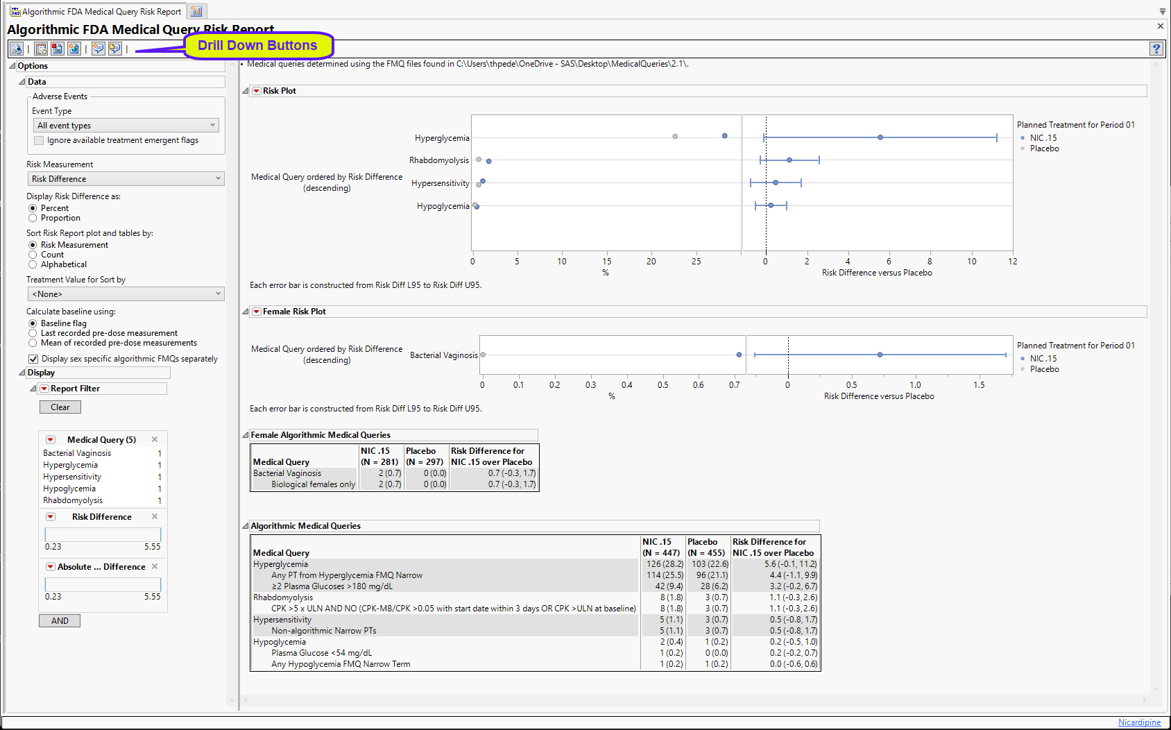

Report Results Description
Running Algorithmic FMQ Medical Query Risk Report for a modified Nicardipine study using FMQ v2.1 files generates the Report shown below.
The Report contains the following elements:

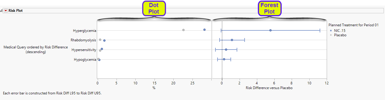

Risk Plot
There are two plots shown here. Medical queries are shown on the y axis. The dot plot on the left of each group shows the percentile occurrence of subjects in each arm exhibiting the queries. The Forest plot on the right of each group shows the risk difference for subjects to exhibit events covered by each query.
Forest Plots display relative strength of treatment effects as horizontal lines representing the 95% confidence interval of the effect observed in that trial. The confidence interval is normally for the relative likelihood of a given nominal-level outcome for the intervention group compared to the control group. In this example, the forest plot shown below, represents the risk difference for developing the specified event relative to exposure to Nicardipine.

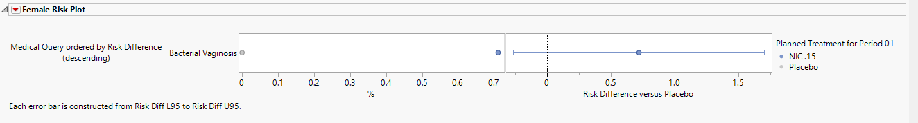

Sex-specific Risk Plot(s)
These plots are like the plots shown above but display sex-specific algorithmic FMQs only. They are surfaced only when the Display sex specific algorithmic FMQs separately option is checked.
In this example, a plot for female-specific algorithmic FMQs is shown. A male-specific plot would also have been shown if any of the subjects had exhibited male-specific events.

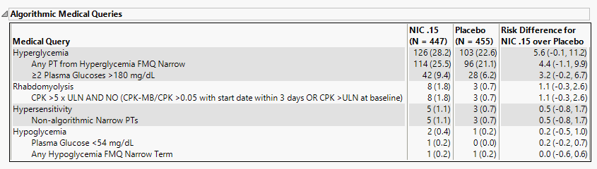

Algorithmic Medical Queries Table
This table lists each query with its associated qualifications, the number (percentile) of subjects exhibiting the event by qualification, and the risk difference between the treatment arms.

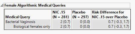

Sex-specific Algorithmic Medical Queries Table(s)
This table is like the table shown above but lists sex-specific algorithmic FMQs only. It is surfaced only when the Display sex specific algorithmic FMQs separately option is checked.
In this example, a table for female-specific algorithmic FMQs is shown. A male-specific table would also have been shown if any of the subjects had exhibited male-specific events.

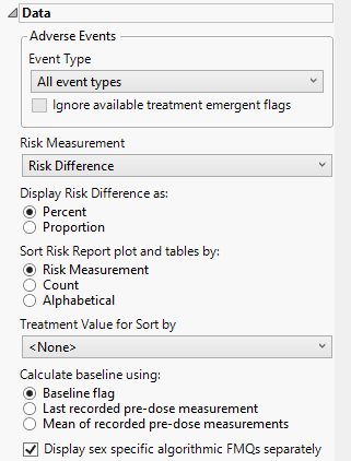

Options
Data
Event Type
Analysis can consider all events or only those that emerge at specific times before, during, or after the trial period. For example, selecting On treatment events as the Event Type includes only those events that occur on or after the first dose of study drug and at or before the last dose of drug (+ the offset for end of dosing).
Ignore available treatment emergent flags
If you choose to Ignore available treatment emergent flags, the analysis includes all adverse events that occur on or after day 1 of the study when the event type is Treatment emergent events.
Risk Measurement
Use the Risk Measurement, option to specify the measure you want to use for defining risk.
Display Risk Difference as:
Use this widget to specify whether to display the risk difference values as either percentages or proportions.
Sort Risk Report plot and tables by:
Use the Sort Risk Report plot and tables by: widget to specify how the rows in the Risk Report plot and tables are to be sorted.
Treatment Value for Sort by:
Use this widget to specify the treatment value to sort the plots and tables by. This is especially useful when there are multiple treatment regimes. Refer to Treatment Value for Sort by for more information.
Calculate baseline using:
Use this widget to specify how the baseline findings measurements should be calculated. Refer to Calculate baseline using: for more information.
Check this option to display male-specific and female specific algorithmic FMQS in separate and distinct plots and tables. When this option is unchecked, sex-specific algorithmic FMQS are included in the main plot and table.

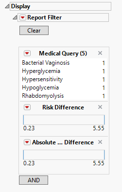

Report Data Filters
These filters enable you to subset and view subjects based on demographic characteristics and other criteria. Refer to Data Filter for more information.
