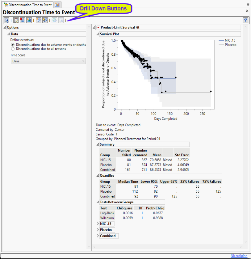

Running this report for Nicardipine using default settings generates the tabbed Results shown below.
Results
Contains a Kaplan-Meier Survival Curve time-to-event analysis that compares the time until discontinuation of individuals in each treatment arm in the study. Otherwise, subjects are censored when they complete the trial. You can define what constitutes a discontinuation using the Define events as: option in the Discontinuation Time to Event.

Discontinuations are determined using the last record per subject where the disposition category is "Disposition Event." When the option for "Definte events as:" is set to Discontinuations due to adverse events or deaths, disposition terms of "DEATH", "DEAD", "DIED" and "ADVERSE EVENT" are all considered discontinuations. When the option is set to Discontinuations due to all reasons, then any disposition event not listed as "COMPLETE" or "COMPLETED" is considered a discontinuation. If a subject does not experience a discontinuation event, they are censored at the date of the last disposition event. If a disposition event does not exist for a subject, then the censor date is set to the last treatment date(TRTSDT) or the reference end date(RFENDTC). Any subjects with a missing disposition date and missing censor date are removed from the analysis and a note will appear at the top of the report to indicate subjects have been removed.
