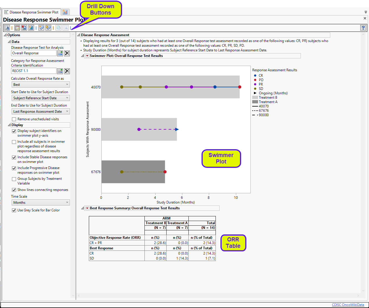

It contains the following elements:
| • | Summary text |
Summarizes the subjects plotted below.
| • | One Swimmer Plot |
The swimmer plots shows each subject’s response to treatment over the course of the study. Each bar represents one subject. Only those subjects who had at least one overall response assessment are plotted. The length of the bars correspond to the time each subject spent in the study and are colored by treatment. Reasons for leaving the study are not indicated. Response to the treatments are illustrated by the color of the dots, connecting lines, and arrows. These change color as treatment responses change. The dots indicate the time when the response was recorded. Arrows indicate ongoing response. This plot is a standard method for presenting these results.
Note: You can set your color preferences using theSet Value Order and Color in Studies utility.
| • | One Objective Response Rate (ORR) Summary table |
This table lists the numbers of the subjects showing complete response (CR) and partial response (PR), as well as those with stable disease (SD) for each treatment. Subjects showing progressive disease (PD) as their best response would also be listed. The table also shows the overall response rate (CR + PR) for each treatment. Total subject counts are also displayed.

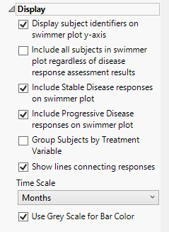

Display
Display subject identifiers on swimmer plot y-axis
By default, subject identifiers are not included on the swimmer plots. Click the Display subject identifiers on swimmer plot y-axis box to display the subject identifiers on the y-axes of the plots.
Include all subjects in swimmer plot regardless of disease response assessment results
You can include all subjects, regardless of disease response by checking the Include all subjects in swimmer plot regardless of disease response assessment results widget.
Include Stable Disease responses on swimmer plot
By default, stable disease responses are not included on the swimmer plots. You can include these responses by checking the Include Stable Disease responses on swimmer plot widget.
Include Progressive Disease responses on swimmer plot
By default, progressive disease responses are not included on the swimmer plots. You can include these responses by checking the Include Progressive Disease responses on swimmer plot widget.
Group Subjects by Treatment Variable
Swimmer plots are presented in order of longest to shortest time subjects have participated in the study, irrespective of treatment. The Group Subjects by Treatment Variable option enables you to group and color-code subjects by treatment.
Show lines connecting responses
Checking the Show lines connecting the responses widget connects the observations with lines.
Time Scale
By default, time is measured in months. However, you can change the Time Scale to plot time in either months or weeks. This option is useful for assessing report graphics for exceptionally long studies.
Use Grey Scale for Bar Color
You can opt to display the bars and response markers on the swimmer plot in grey scale by checking the Use Grey Scale for Bar Color widget.
Action buttons, provide you with an easy way to drill down into your data. The following action buttons are generated by this report:
| • | Click to rerun the report using default settings. |
| • | Click to view the associated data tables. Refer to Show Tables/View Data for more information. |
| • | Click to open and view the Review Subject Filter. |
| • | Click to specify Derived Population Flags that enable you to divide the subject population into two distinct groups based on whether they meet very specific criteria. |
