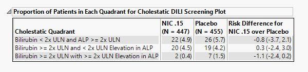

Proportion of Patients in Each Quadrant for Cholestatic DILI Screening Plot
The table shown in this section summarizes the patients showing evidence (high bilirubin and/or alkaline phosphatase) of cholestatic liver injury from the Peak Liver Test Results plot above.
The number of patients as well as the percentage of patients (in parentheses) for Cholestatic disease are displayed. Risk differences are calculated by subtracting the number of patients exhibiting changes, in maximum bilirubin and/or ALP measurement values, indicative of damage in the control group from the number of patients exhibiting corresponding values in the treatment arm.

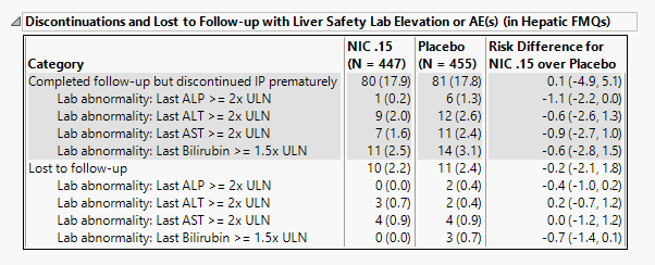

Discontinuations and Lost to Follow-up with Liver Safety Lab Elevation or AE(s) (in Hepatic FMQs)
The plot in this section shows the proportion of patients with liver damage who either discontinued or left the trial.
The number of patients as well as the proportion of patients (in parentheses) exhibiting abnormal liver tests and/or hepatic adverse events and either discontinued or were otherwise lost to follow-up assessments are displayed. Risk differences are calculated by subtracting the number of discontinued or lost patients in the control group from the number of patients exhibiting corresponding values in the treatment arm.

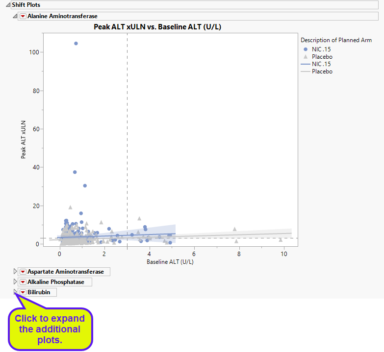

Shift Plots
These plots show how findings levels change from baseline values as a result of treatment.
Blue points represent patients treated with nicardipine. Gray points represent patients receiving the placebo. The approximately square spread of points (with a diagonal line splitting approximately even across it) indicates similar variability of measurements before and after treatment.

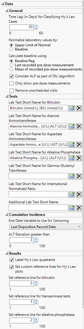

Options
Data
Time Lag (in Days) for Classifying Hy's Law Cases
Use this option to specify a lag time for classifying a subject as a Hy's Law case. See Time Lag (in Days) for Classifying Hy’s Law Cases for more information.
Normalize laboratory values by:
You can choose to normalize the measurements by either the ULN or the baseline measurements for each test. You can select either the last pre-dose values or the means of all pre-dose values as the baseline See Normalize laboratory values by: for more information.
Calculate baseline using:
Use this option to specify how the baseline findings measurements should be calculated for normalization. See Calculate baseline using: for more information.
Consider ALP as part of the DILI algorithm:
Use this option to include the ALP test measurements when determining whether a patient meets Hy's Law criteria.to determine possible Hy's law cases. See Consider ALP as part of the DILI algorithm for more information.
Only show predose measurements
Check this option to exclude all on-trial measurements from the analysis. This option enables you to observe all subjects at baseline. See Only show predose measurements for more information
Remove unscheduled visits
You can restrict the analysis to data from scheduled visits by checking the Remove unscheduled visits box.
Lab Test Short Name for Bilirubin
The Lab Test Short Name for Bilirubin option enables you to specify a non-standard test name for the bilirubin test. If this option is left blank, JMP Clinical uses the standard test designation.
Lab Test Short Name for Alanine Aminotransferase
The Lab Test Short Name for Alanine Aminotransferase option enables you to specify a non-standard test name for the alanine aminotransferase test. If this option is left blank, JMP Clinical uses the standard test designation.
Lab Test Short Name for Aspartate Aminotransferase
The Lab Test Short Name for Bilirubin option enables you to specify a non-standard test name for the aspartate aminotransferase test. If this option is left blank, JMP Clinical uses the standard test designation.
Lab Test Short Name for Alkaline Phosphatase
The Lab Test Short Name for Alkaline Phosphatase option enables you to specify a non-standard test name for the alkaline phosphatase test. If this option is left blank, JMP Clinical uses the standard test designation.
Lab Test Short Name for Gamma-Glutamyl Transferase
The Lab Test Short Name for Gamma-Glutamyl Transferase option enables you to specify a non-standard test name for the gamma-glutamyl transferase test. If this option is left blank, JMP Clinical uses the standard test designation.
Lab Test Short Name for International Normalized Ratio
The Lab Test Short Name for Bilirubin option enables you to specify a non-standard test name for the international normalized ratio. If this option is left blank, JMP Clinical uses the standard designation.
Additional Lab Test Short Name
The Additional Lab Test Short Name option enables you to specify an additional test yo be included in the analysis. I
End Date Variable to Use for Censoring
Use the End Date Variable to Use for Censoring option for specifying the end date for censoring. Options include the date of the last disposition (selected by default) and the record reference end date.
ALT Elevation greater than
By default, ALT levels equal to or greater 3*ULN are considered as events for the cummulative incidence screen. ALT levels below this values are not. You can change the value of this cutoff using the ALT Elevation greater than option.
Label Hy's Law quadrants
Selecting Label Hy’s Law quadrants places identifying labels, relating to Hy’s law, in each quadrant of all of the plots of bilirubin versus alanine aminotransferase.
Set custom reference lines for Hy's Law plots
Use the Set custom reference lines for Hy’s Law plots option to draw reference lines on the Hy’ Law plots. You must then specify reference lines for bilirubin, the transaminases, and alkaline phosphatase.
Set reference line for bilirubin
By default, the reference value for bilirubin is set to 2 or twice the ULN. You must then use the Set reference line for bilirubin option to specify an alternative value by which to multiply the ULN for bilirubin.
Set reference line for transaminase tests
By default. the reference value for the transaminase tests is set to 3 or 3x the ULN. You must use the Set reference line for transaminase tests option to specify an alternative value by which to multiply the ULN for alanine and/or aspartate transaminase.
Set reference line for alkaline phosphatase
By default, the reference value for alkaline phosphatase is set to 2 or twice the ULN. You must then use Set reference line for alkaline phosphatase option to specify an alternative value by which to multiply the ULN for alkaline phosphatase.
