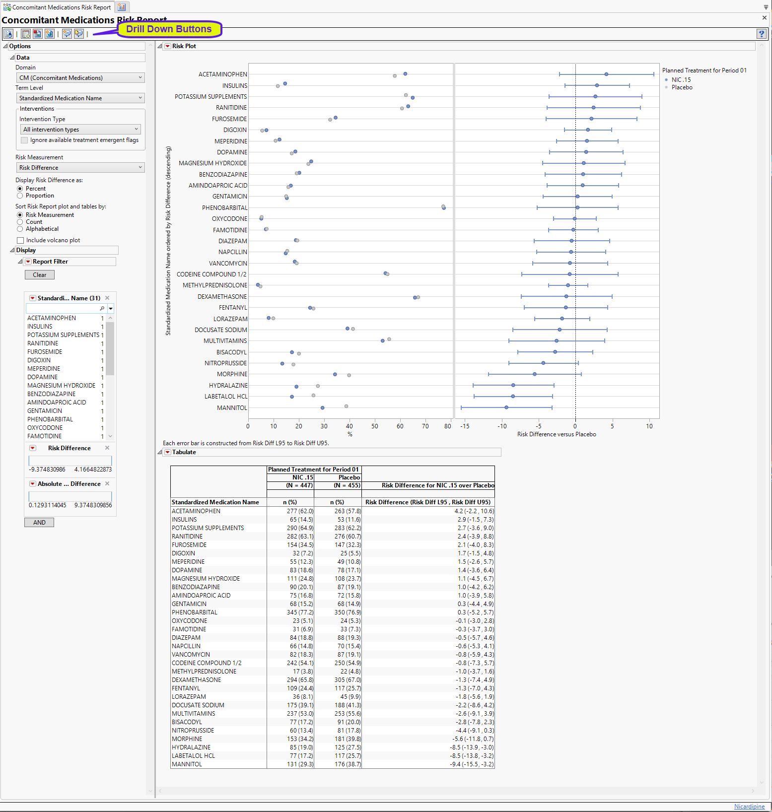

Running this report for Nicardipine using default settings generates the report shown below.
Refer to the Adverse Events Risk Report , keeping in mind the following important differences in contrast with the example:
| • | Output (including section names) reflects intervention incidence corresponding to selected domain (e.g. Concomitant Medication, Substance Use), rather than adverse events, incidence |
| • | Term Level is allowed to equal Category (such as CMCAT or SUCAT, depending on the domain) |
Refer to Confidence Intervals for information on how JMP Clinical calculates and uses confidence intervals.
