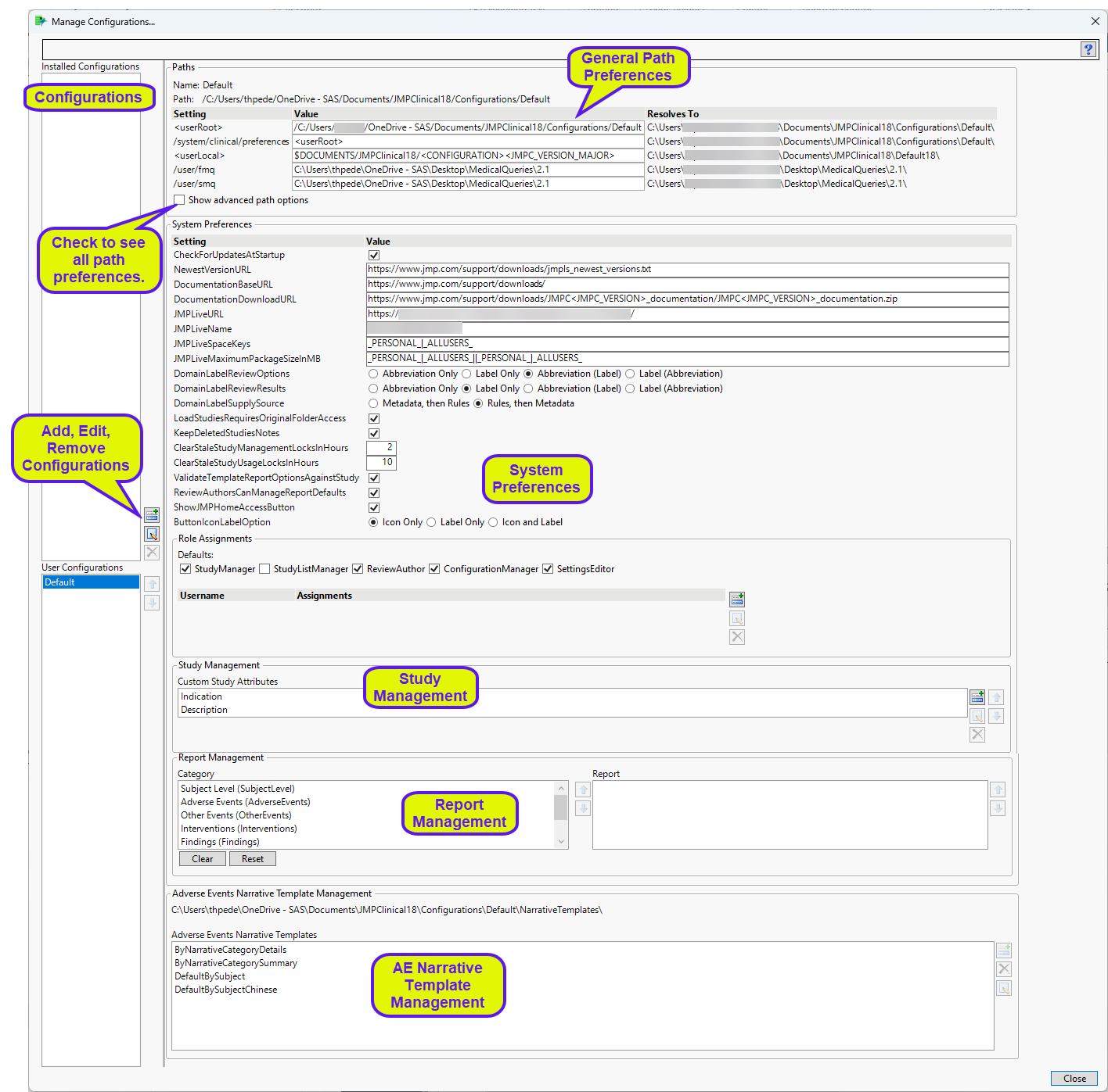

Manage Configurations
The Manage Configurations... window is accessed from the Settings tab of the JMP Clinical Main Window.
| 8 | Click to open the Manage Configurations... window, shown below: |

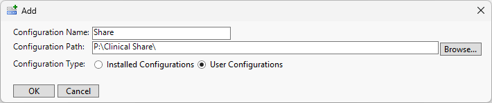

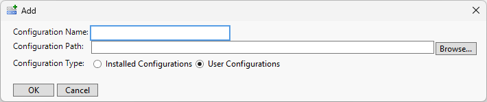

| 8 | Click to open the Add window shown below: |
| 8 | Specify a name for your configuration. |
In this case, the configuration is named Share.
| 8 | Click to open a Choose Directory window. |
| 8 | Navigate into the Clinical Share folder and click . |
| 8 | Click the User Configurations radio button. |
The Add window appears as shown below:
| 8 | Click . |

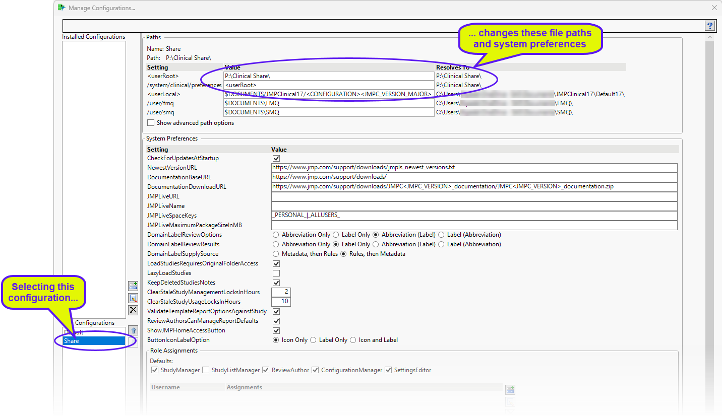

The new configuration is added to the Manage Configurations window. If you select it, all of the default paths and system preferences are displayed, as shown below:
Note: While all paths and preferences are editable, you should consult your system administrator before making any changes.
