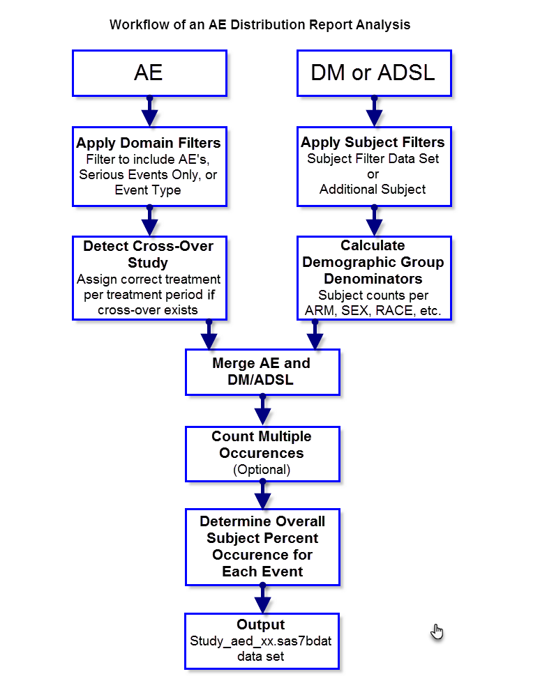

Distribution Workflow Summary
The following diagram outlines the analysis performed to summarize adverse events count and percent calculations for the Adverse Events Distribution report.
Distribution Workflow Steps

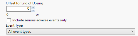

Apply Domain Filters
Three parameters, Offset for End of Dosing, Include serious adverse events only, and Event Type, available in Set Study Preferences, are used to specify a domain filter.
Note: These options are specified on the Set Study Preferences panel.
Available options are described in the following table:
Option: |
Select when you want to: |
Event Type options rely on the available Date/Time start and end variables referenced above. Options include: |
All event types |
Pre treatment events |
Treatment emergent adverse events |
On treatment events |
Off treatment followup events |
You can also use the Include the following adverse events: and Filter to Include Adverse Events options based on user-customized condition and/or on new/modified/stable records (when JMP Clinical snapshot comparison is being used)
Apply Subject Filters
These options filter the available subjects to use for the analysis and impact both the counts of adverse events (relevant events are considered only for subject in the analysis population) as well as for computing denominators to perform subject percent calculation.
Three parameters, Select saved subject filter, Additional Filter to Include Subjects and Select the population to include in the analysis, are used to specify a domain filter.
Option: |
Select when you want to use a: |
Detect Crossover Study
If an ADSL table is defined and contains multiple treatment periods (TRTxxP for example) and treatment period start/stop dates, ADSL is merged in and the corresponding treatment and period is assigned based on comparison with AESDTC.
Calculate Demographic Group Denominators
Fixed adverse event frequency/percent values are not computed from output in the results data set. Instead, the subject counts for all relevant treatment and demography variables are computed, in order to support interactive computation of AE subject percent calculations based on user filtering and selection of treatment or demographic group categories.
Note: If you want to output static AE percent tables only, the Create Static Report(
) action button should be used.

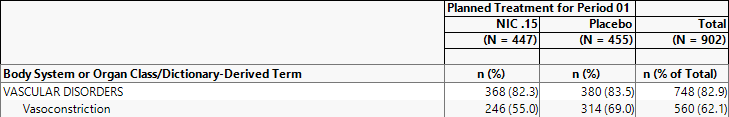

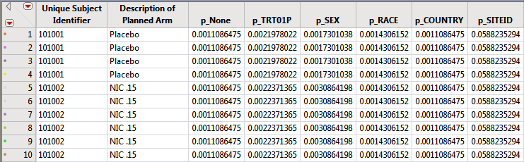

The subject counts for each value of relevant demographic variables (Treatment, SEX, RACE, COUNTRY, SITEID, STUDYID (if not constant) are computed and then the reciprocal of the subject count is recorded in the DM or ADSL data set for merging into AE. This value can be used as a frequency weight for each subject that has a specific event to calculate the percent of subjects for that given demographic group that experience the AE.
The following example uses the Nicardipine data included with JMP Clinical.
In this example:
| • | 455 subjects were on Placebo. |
| • | The reciprocal 1/455 = .00219. This value can be used for each subject that has an AE to compute the percentage. |
| • | 314 subject on placebo experience Vasoconstriction. |
| • | 314 x 1/455 = 314/455 = .6901 or 69.0% of subjects on placebo experienced Vasoconstriction. |
These reciprocal or frequency variables based on the demographic variable counts for each subject are computed and used when merged into the AE records table to compute percentages.
These columns are used in the distribution results dashboard to dynamically calculate percentages. Further examples are given when describing the dashboard results.
Note: If crossover is detected, these demographic counts represent the total subjects for treatment values summed across each period.
Merge AE and DM/ADSL
The (filtered) AE data and the (filtered) DM or ADSL table (with computed demographic frequencies) are merged by USUBJID (and treatment period if crossover is detected)
After all of these steps have been completed, the STUDY_ae_xx.sas7bdat results table is used for the JMP results dashboard report.

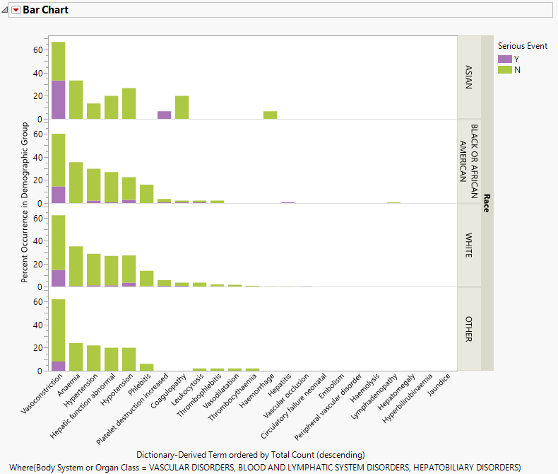

The AE Distribution report described in this example is shown below:

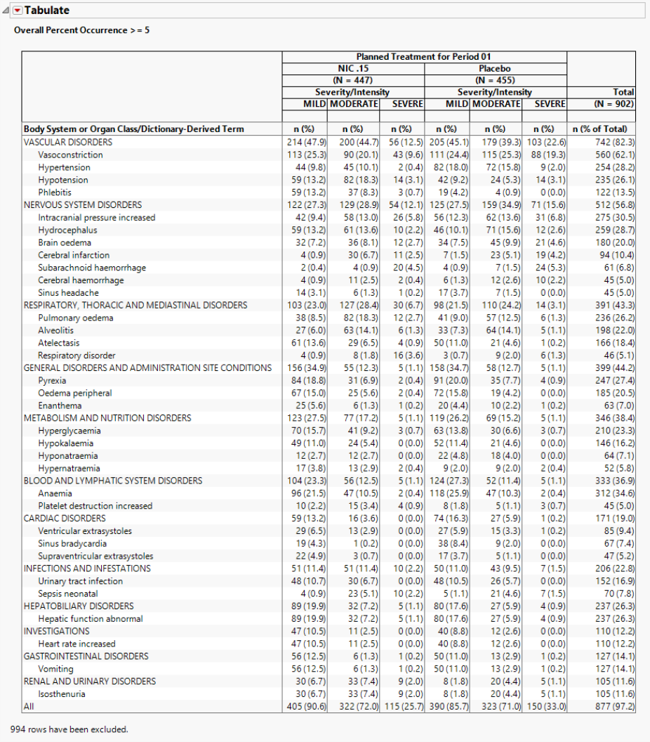

Example 1: AE Distribution Treatment Emergent Adverse Events That Occur in at Least 5% of Subjects in a Safety Population

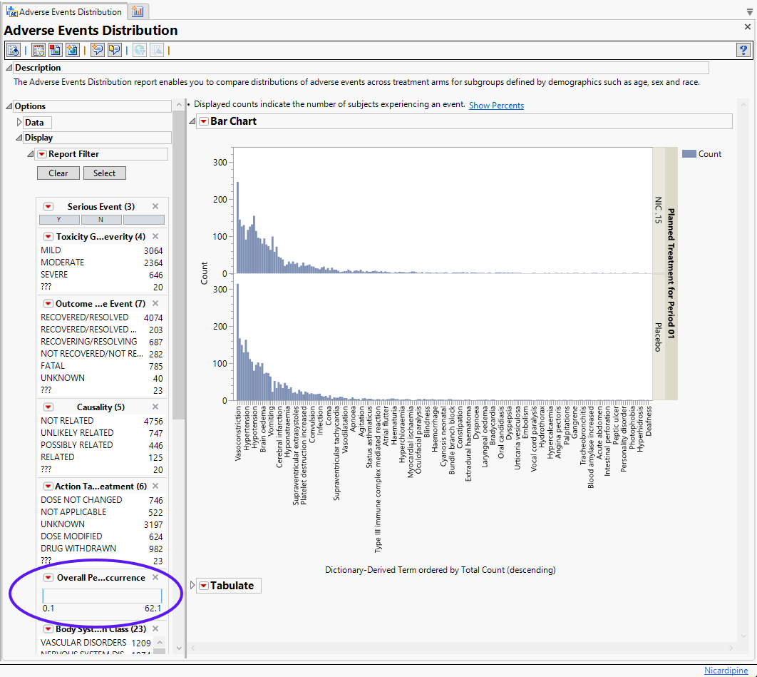

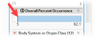

| 8 | Open Adverse Events Distribution. |
| 8 | Find the Display widget that enables you to set the overall percent occurrence (circled below): |
| 8 | Use your cursor to "grab" the lower limit and drag it to 5%. |

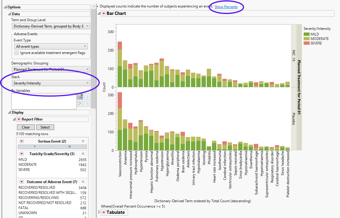

| 8 | Adjust the Stack widget to display results by Severity/Intensity. |
The results of this analysis are based on summarizing adverse events by Dictionary-Derived Term (AEDECOD) with group organization as Body System or Organ Class (AEBODSYS). Variations of options for this are dependent on the available terms in the domain data set.
The counts (Y axis) represent the count of subjects that experienced the given event term (X axis); the counts are categorized as stacked bar charts for levels of Severity/Intensity (AESEV). This categorization is a result of choosing that variable from the AE Stacking action button.
When a unique occurrence is counted only for each subject/event, the percent of subjects experiencing an event within any of the available demographic grouping variables is calculated interactively by the report. The plot below was generated by clicking Show Percents (circled above).

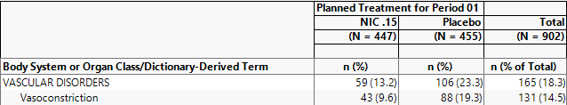

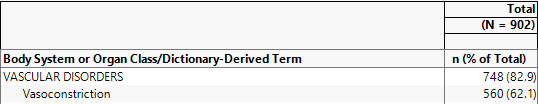

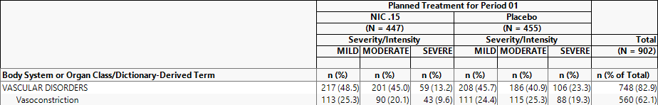

The table (shown below) reflects the same counts/percentages as shown in the counts plot in tabular form. The Grouping and Stacking column from the down panel drive the format and detail in this table. This flexibility enables you to create several tables for summarizing events from one report.
Rows that do not meet the overall percent occurrence specified in the options (5% in this example) are hidden and excluded from analysis.

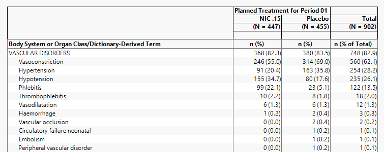

Examples in AE Distribution Using Nicardipine Data (Treatment Emergent Events):

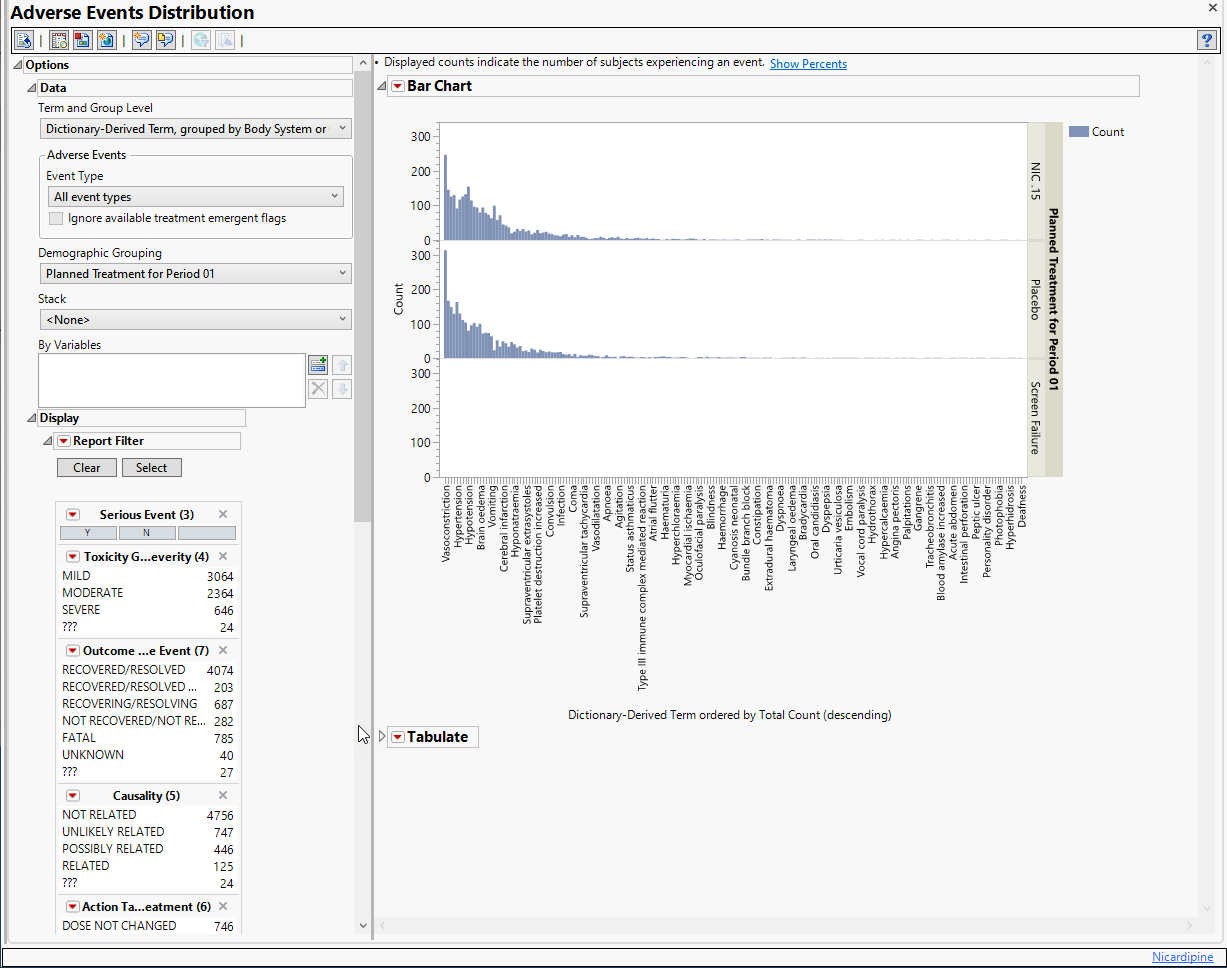

This study has 902 subjects in the safety analysis population with 455 on Placebo, 447 on NIC .15.
Example 1: Using the options under Data , select None for Demographic Grouping and None for Stack and examine the table.
560/902 = .621 62.1% of subjects experienced (treatment emergent) vasoconstriction
Example 2: Using the options under Data , select Planned Treatment for Period 1 for Demographic Grouping and None for AE Stacking and examine the Counts Table tab. Note how the values change.
168/447 = .376 37.6% of subjects on NIC .15 experienced vasoconstriction
239/455 = .525 52.5% of subjects on Placebo experienced vasoconstriction

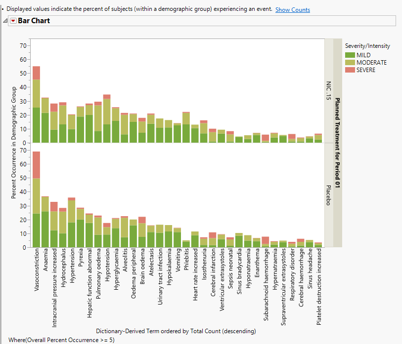

Example 3: Using the options under Data , select Planned Treatment for Period 1 for Demographic Grouping and Severity/Intensity for AE Stacking and examine the Counts Table tab. Note how the values change.
113/447 = 25.3% of subjects on NIC .15 experienced MILD vasoconstriction
90/447 = 20.1% of subjects on NIC .15 experienced MODERATE vasoconstriction
43/447 = 9.6% of subjects on NIC .15 experienced SEVERE vasoconstriction
111/455= 24.4% of subjects on Placebo experienced MILD vasoconstriction
115/455= 25.3% of subjects on Placebo experienced MODERATE vasoconstriction
88/455= 19.3% of subjects on Placebo experienced SEVERE vasoconstriction
Note: In the example, the demographic group column changes the percent calculations (also known as changes the value of the denominator used in the formula), while the stacking/categorization variable just partitions the counts and percentages.
The value of percent calculation comparison can be seen clearly in the two plots shown below. The first plot shows the AE Counts graph grouped by RACE and categorized by Serious Event.
This plot can be misleading because of the large differences in the respective number of subjects in each RACE category. In this case, comparing the percentages might be more informative.
| 8 | Click Show Percents (located above the plot and circled below). |
The resulting plot (below) then is much more useful for making comparisons.

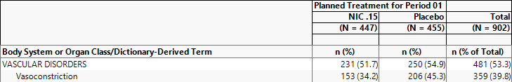

Percent Calculations When an Interactive Data Filter Is Applied.
When you use the Report Filter (located on the left side of the report) to filter the records that are shown, the change does NOT affect the demographic group denominator values that are used in the percent calculations. These denominators, as described previously, are derived in the SAS programming of the analysis based on the analysis population. The counts (the numerator in the percent formula) of subjects experiencing the event (and now meeting the data filter criteria) change values to reflect the use of the data filter.
In the following example, the default (Event Type = All) Adverse Events Distribution report was run for the Nicardipine sample data and the results were subsequently filtered for Serious Event = Y, as shown below:
The results are shown below:
88/455 = 19.3% of subjects on Placebo experienced serious vasoconstriction.

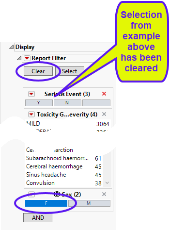

If the Data Filter selection is based on a demographic variable, care must be taken to interpret the results.
In the following example, Sex = F has been selected in the data filter:
Note: You must click (circled above) to clear out prior filters before making a new selection.
206/455 = 45.3% of subjects on Placebo were females with vasoconstriction.

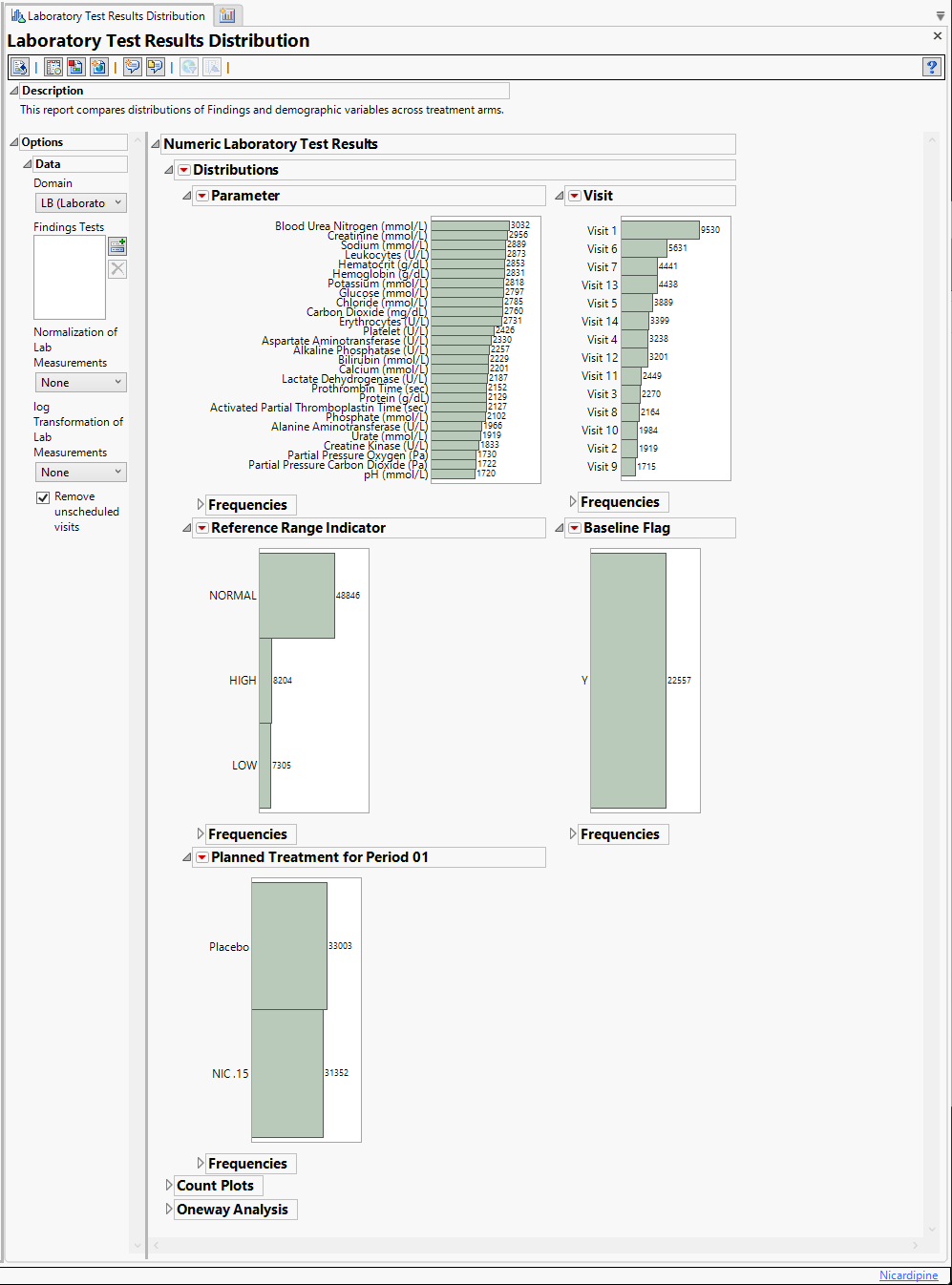

For the Findings Distribution report, these distributions are the initial view. The findings calculations follow the same workflow as described by the events computation, but are simpler because no percent calculations are performed. Most of the analyses are derived using the JMP reports.
Findings Distributions Results
The Findings Distribution report might contain the following results:
| • | Distributions: Contains distributions of parameters from the specified Findings domain. |

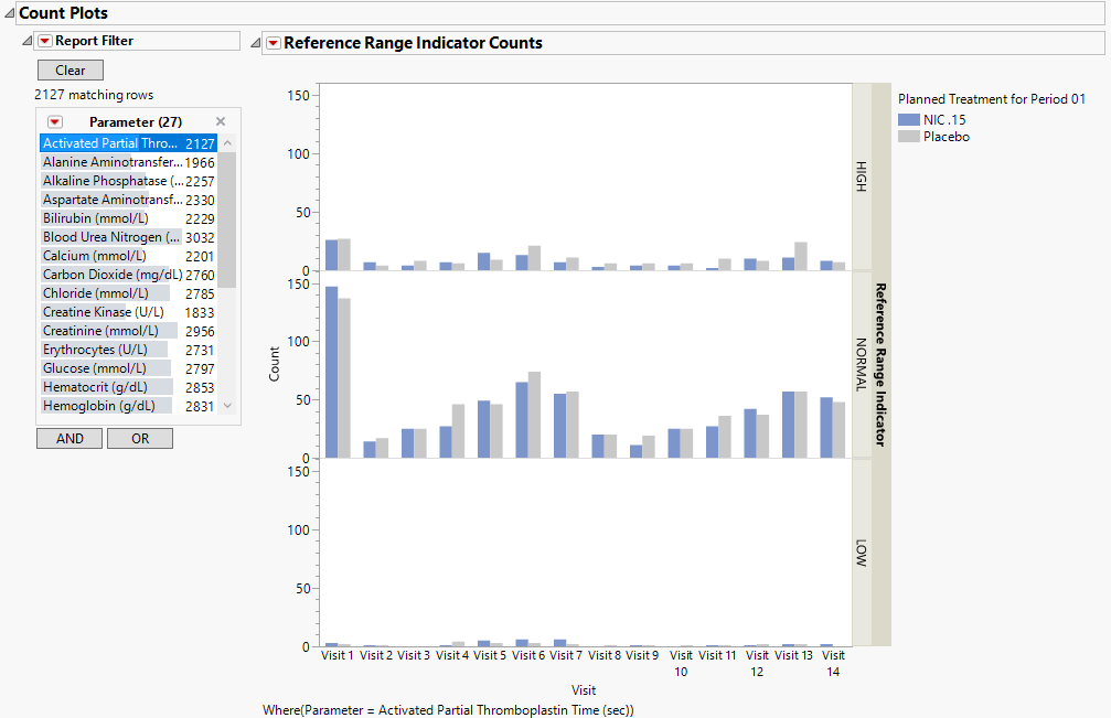

| • | Count Plots: Contains graphs for each test to display measurement counts within categories of the Reference Range Indicator variable. This tab is displayed only if the xxNRIND variable is present in the Findings domain data (typically the LB domain). |
| • | Test Results: Contains One-way Analyses (ANOVA) for each test that has numeric measurement results (xxSTRESN values), Contingency Analyses for each Findings test that has character results (xxSTRESC values but missing xxSTRESN values), or both. |
| • | Missing Test Details: Contains tables displaying subject counts for tests that were either not recorded, or that were recorded but have missing measurement values (of xxSTRESN and/or xxSTRESC). If all subjects had nonmissing recorded test measurements for all tests, this tab is not shown. |
The Distribution tab is shown above. The other three tabs are shown below:

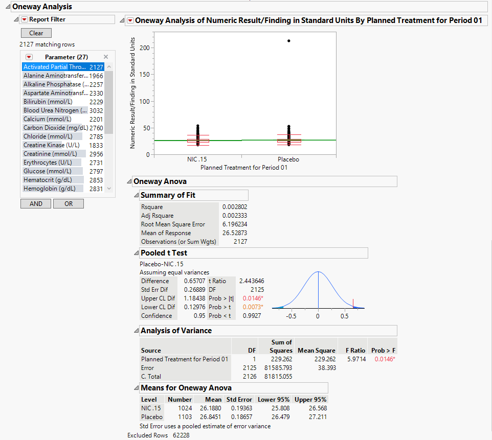

Count Plots: This plot shows counts of records from the Findings domain by Study Visits. The xxNRIND and either the VISIT or VISITNUM variables are required in the domain in order to produce these plots.
Oneway Analysis: This report section displays either an ANOVA (numeric tests) or a Contingency analysis (character findings) comparing findings measurement values across treatment or comparison variable for each test in the domain. In the example setting, there are no character test findings, so the contingency analysis is not shown here.
