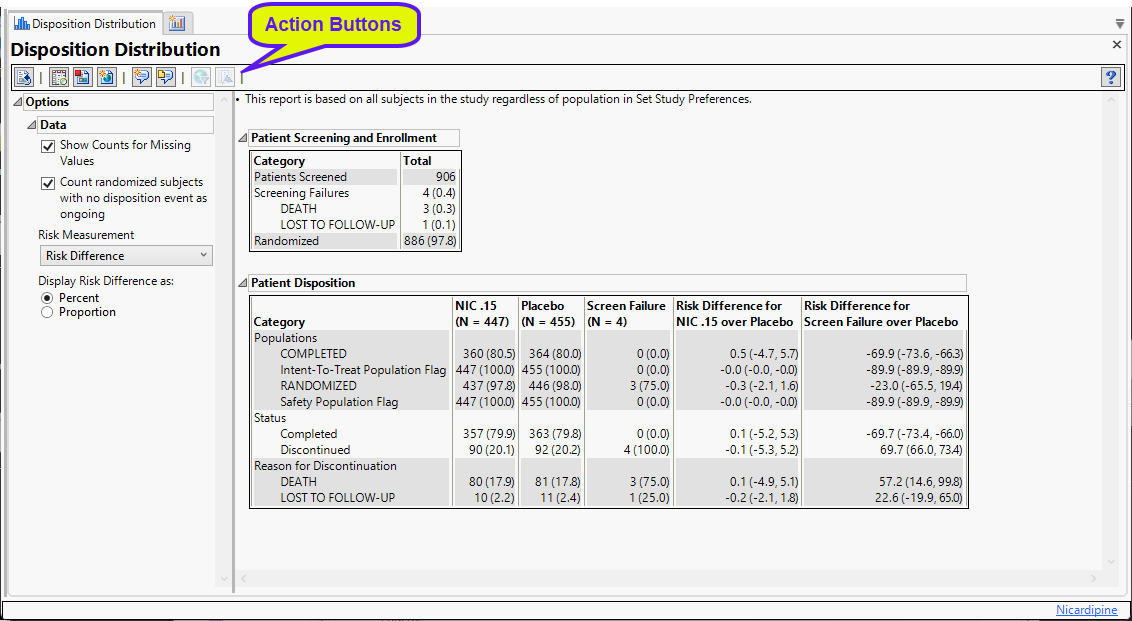

Disposition Distribution
This report generates tables showing the distribution of dispositions and associated risk differences of study patients across treatment arms.
Report Results Description
Running this report for Nicardipine using default settings generates the Report shown below.
The report contains the following two tables:
Patient Screening and Enrollment
This table lists the number of subjects screened, enrolled, and randomized in the study as applicable, as well as the number of screen failures with the reason for failure..

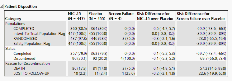

Patient Disposition
This table lists counts and percentages, along with risk difference measurements, of subjects dispositions by treatment arm. Categories include the study populations, completion status, and reason for discontinuation.
Options
Data
Show counts for missing values
Check this option to show counts of subjects who are missing disposition information. For example, subjects who left the study but the reasonfor their discontinuation is missing or subjects whose completion/discontinuation status is missing all together.
Count randomized subjects with no disposition event as ongoing
Check this box to count subjects who do not have a record in DS for either Completed or Discontinued as Ongoing for treatment and study status. Only subjects who have been randomized will be counted as Ongoing.
Risk Measurement
You have the option of calculating either the Risk Difference, the Relative Risk, or the Odds Ratio as the Risk Measurement.
Display Risk Difference as:
Use this widget to specify the difference between the risk of an event in the treatment arm and the control arm as either a percentage or a proportion of the total subject population. This widget appears only when you select Risk Difference as the Risk Measurement.
