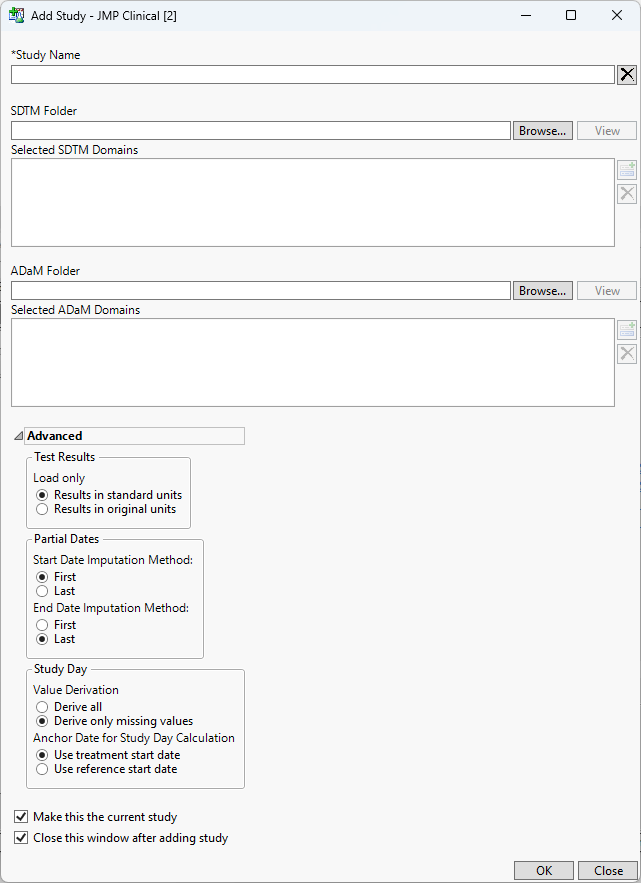

To Add a Study
8 Click to open the dialog:
8 Specify the desired options and click .
The following options are available. Links to specific documentation for each of the options are provided in the following table:

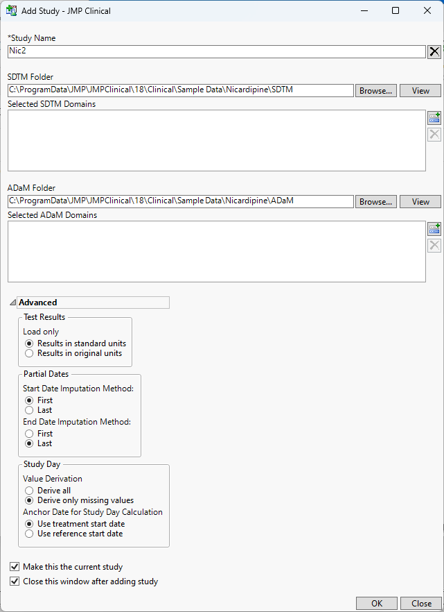

Example: Adding the Nicardipine Study
JMP Clinical ships with the data from a Nicardipine study. The data files are located in the Sample Data in your Installation directory (typically C:\ProgramData\SAS\JMPClinical\18\Clinical\Sample Data\Nicardipine for Windows machines and /Library/Application Support/JMP/18/Clinical/Sample Data for MACs). In this example, we add a clinical study we call Nic1.
Note: The C:\ProgramData\ directory may be hidden by default. Click View > Show > Hidden Items to view.
8 Click to open the Add Study dialog.
8 Specify the name of the study.
8 Specify the file paths to the SDTM and ADaM folders either by typing the path directly or clicking and navigating to the folders.
8 Accept default setting for all other options.
The completed dialog appears as follows:
8 Click to add the study.
When the add study process is complete, the following Results window appears.
When a study has been successfully added, the new study appears in the Studies window.
