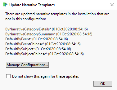

Note: If JMP Clinical detects a template that is older than the current configuration, you will be prompted (with the following window) to update the narratives using the Manage Configurations process
