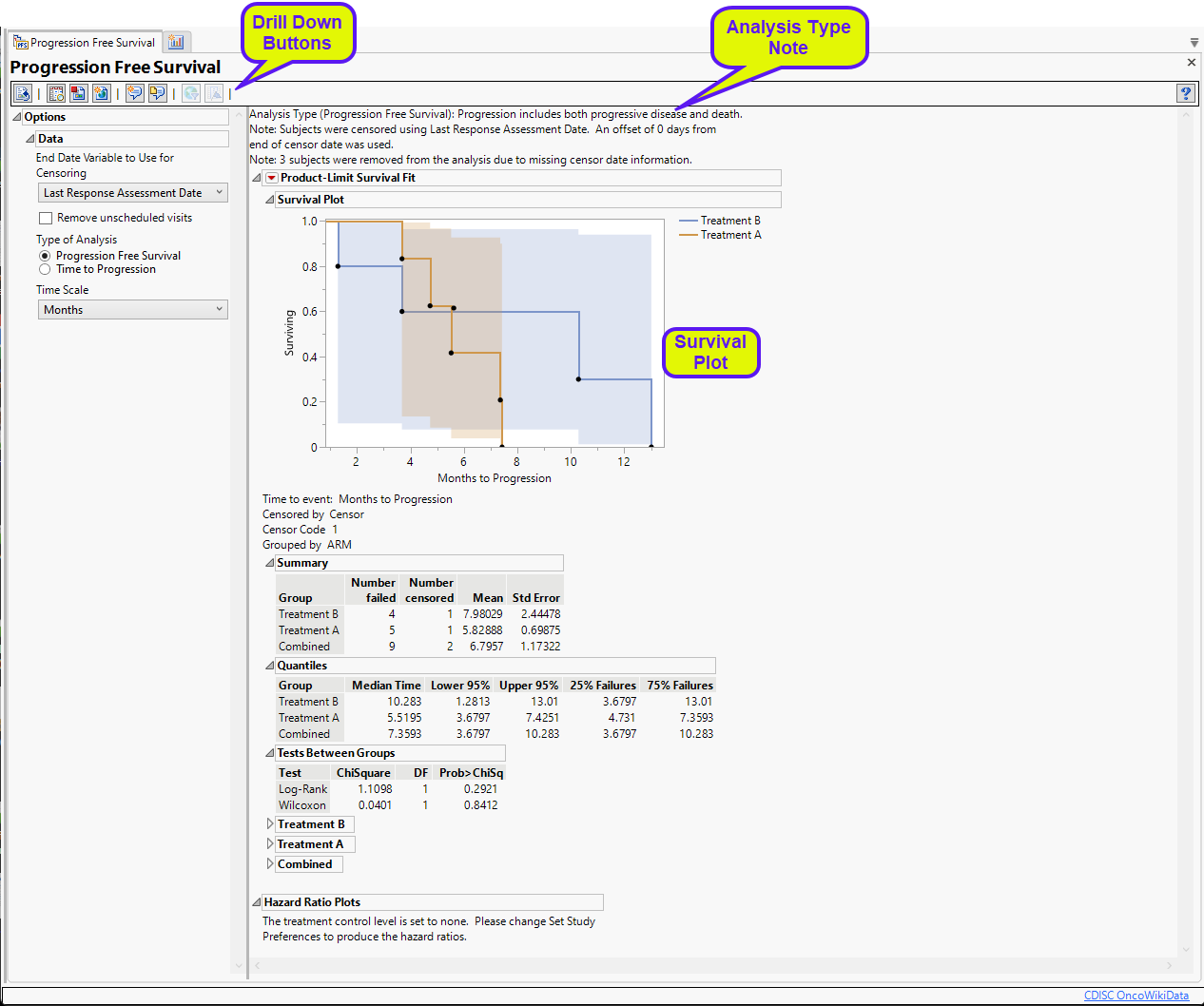

Progression free survival is used to describe how long patients can go without the disease without getting worse. This process uses a modified survival plot to compare the number and percentage of patients who have tumor progression or death, with patients who show no tumor progression or death at the cut-off date. Results are summarized in a set of tables.
Report Results Description
Running this report for a modified Nicardipine study using default settings generates the report shown below.
It contains the following elements:
| • | Summary text |
Summarizes the subjects plotted below.
| • | One Survival Plot |
This plot shows the probability of patients showing no disease progression over the course of the study. The plateaus indicate that the probability of not progressing remains the same during that period. The dots indicate that patients have either shown disease progression or have left the study (withdrawal or death). The connecting lines are colored by treatment.
| • | Associated Summary tables |
The tables summarize the response and statistics of patients receiving the treatment or control.
Hazard Ratio Plots
The hazard ratio event plot displays the relative disadvantages between two different treatment regimes on the survival of subjects in a study.
No hazard ratio plots are displayed in this example because, by default, the treatment control level is set to <None> in Set Study Preferences. You must specify a treatment arm as the control to see these plots.
