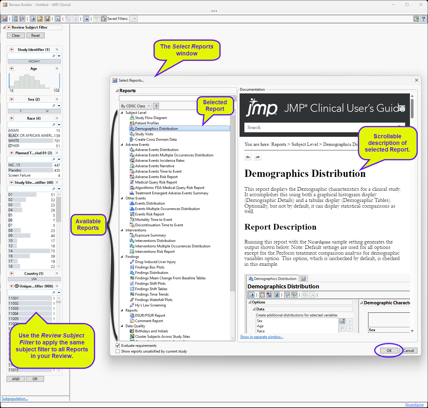

8 Click to open the Review Builder and Select Reports... windows (shown below).
The Select Reports... window lists all of the reports that are available for analyzing the specified study. This window is used to select the reports that are to be included in the review.
Note: Normally, only those reports whose domain/variable requirements are satisfied, and therefore can be run are shown. Check the Show reports unsatisfied by the current study check box to show all reports.
8 Select the report(s) that you want to run and click .

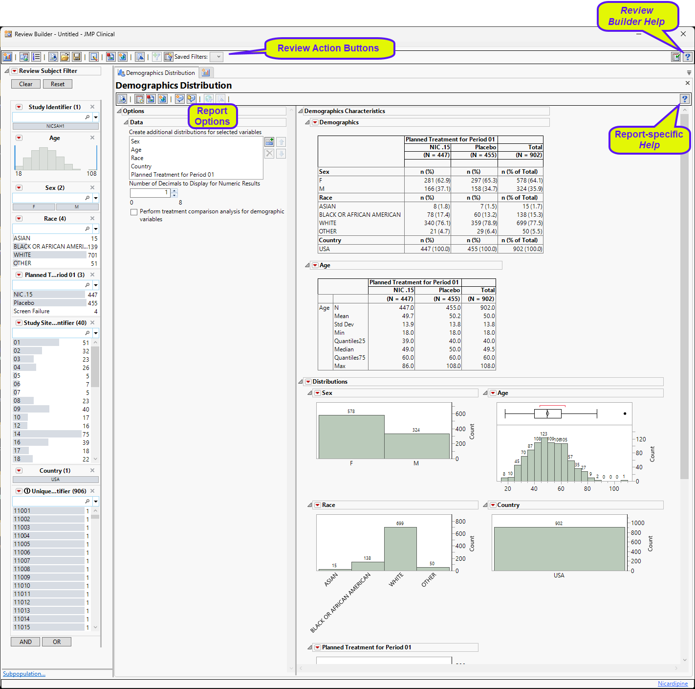

The Review Builder window contains all of the specified reports. There is a separate tab for each report. Initially, each tab lists the options for the analysis. You can accept the default settings or adjust them as desired. After the report(s) is run, results are shown in the tab.
Note: You may see a delay when you open the Review Builder after a study is added or refreshed (or just opened after a long period of inactivity) or when a JMP Add-in has been added to your configuration. This occurs because JMP Clinical must rebuild the report requirement caches before you can proceed.
The following action buttons are available on the Review Builder to enable you to add or delete reports and run, save, or change the review. Note: Action buttons are active only when the requirements for their function are met.

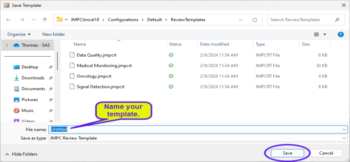

8 Click
The Save Template window (shown below) appears.
8 Provide a name for your template and click to template with the reports and options specified.
Note: By default, review templates are saved to C:\Users\username\Documents\JMPClinica17\Configurations\Default\ReviewTemplates. If you want to save your templates elsewhere, simply navigate to the correct location before clicking .

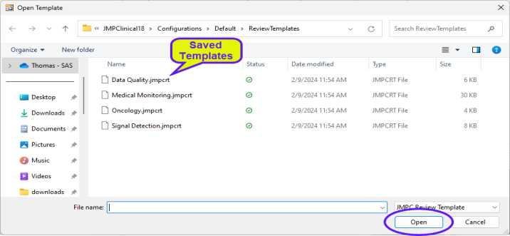

8 Make sure that the new study has been selected.
8 Click to open the Open Template window shown below:
8 Select the desired template and click to open the Review Builder window with the reports and options specified
