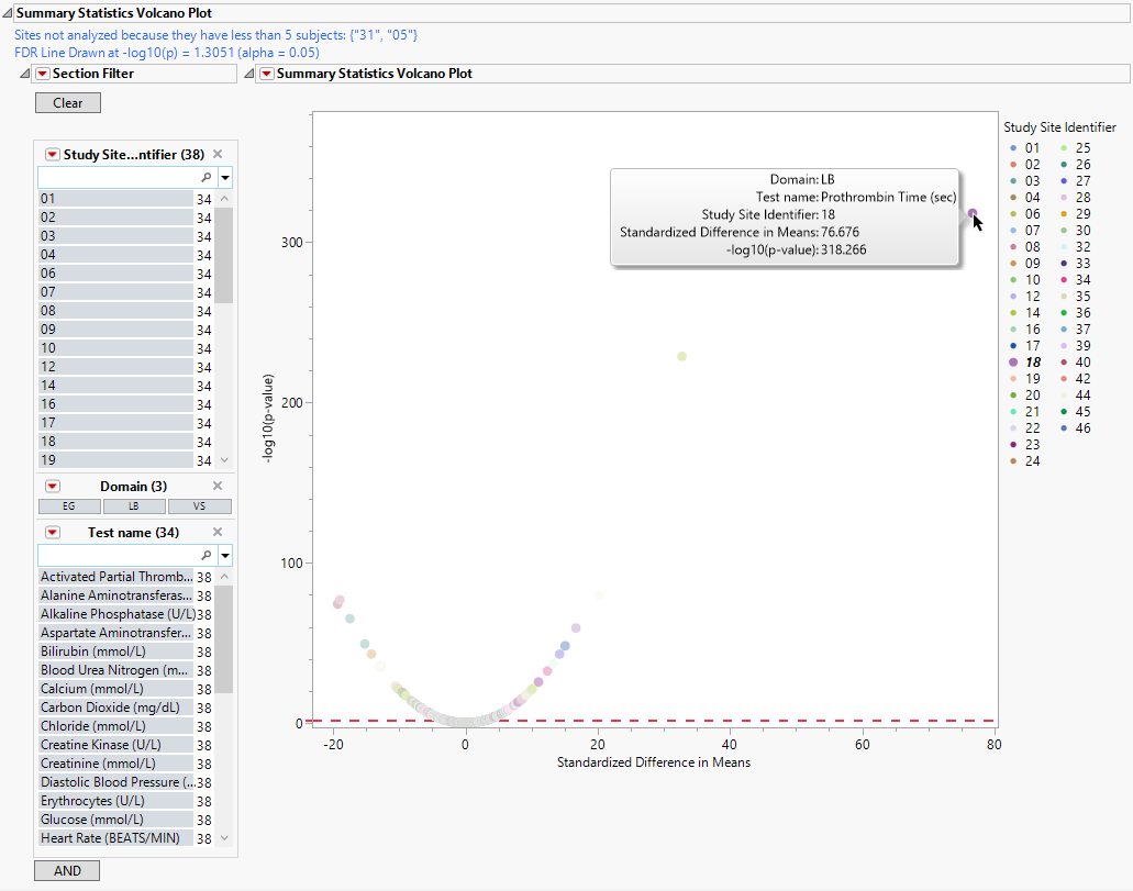

Summary Statistics Volcano Plot
Shows a volcano plot used to determine the deviation of a mean or variance for Findings tests at a site versus other sites. Each point represents a single Findings test for a specific site. Here, the X axis represents the standardized difference in means between each between the site and the reference set (all other sites). For comparisons of variances, the X axis represents the log2(Ratio of Variances) between the site and the reference set.
This section can differ depending on the type of analysis that you perform.
Analysis of Mean or Variance
If you specify either Mean or Variance, you generate a volcano plot similar to that shown below:
This section contains the following elements:
| • | One Subject Filter. |
Enables you to subset subjects based on country of origin, study site and/or Test. Refer to Data Filter for more information.

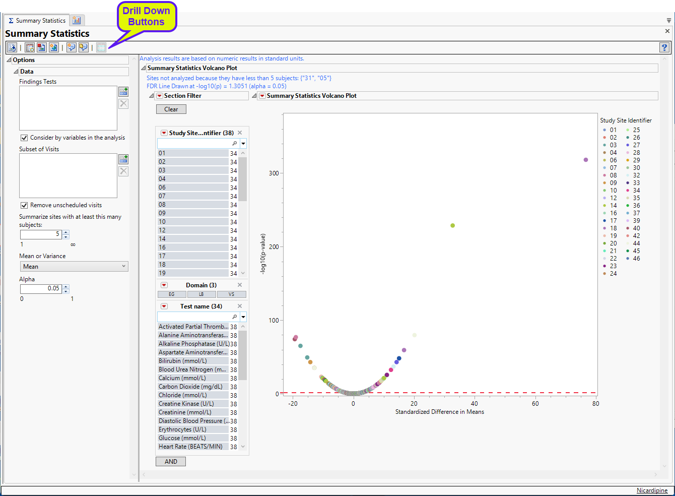

| • | One Volcano Plot. |
The volcano plot is used to determine the deviation of a mean or variance for Findings tests at a site versus other sites. Each point represents a single Findings test for a specific site. Here, the X axis represents the standardized difference in means between each between the site and the reference set (all other sites). For comparisons of variances, the X axis represents the log2(Ratio of Variances) between the site and the reference set. -log10 (p-values) are plotted on the Y axis. While most of the findings are close to the means across all of the sites. some of the points lie farther to the right or left of 0, indicating larger differences between the site and the reference set.

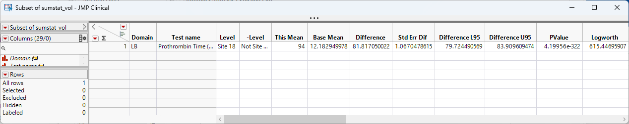

You can mouse over points of interest to see their labels or select points by dragging a mouse rectangle over them (as shown above). Selected rows are highlighted in other plots and you can also then click on various Drill Down Buttons for further analyses on those specific sites. In this example, we click
to view summary statistics for the selected point skewed to the right. The corresponding row is viewed in the following subset.

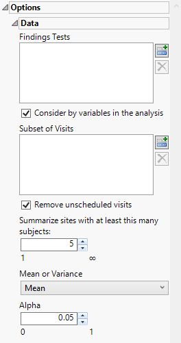

Options
Data
Findings Tests
Use this widget to select Findings Tests for the analysis. The report will autorun and analysis is restricted to the selected tests only.
Consider BY variables in the analysis
You can opt to Consider BY variables in the analysis. This option, which assumes that BY variables (left vs. right arm for collecting blood pressure data, for example) are included in the experimental design, is selected by default. You can uncheck this option to ignore BY variables.
Subset of Visits
Use the Subset of Visits option to select the visits to be included in the analysis.
Remove unscheduled visits
You might or might not want to include unscheduled visits when you are analyzing findings by visit. Check the Remove unscheduled visits to exclude unscheduled visits.
Summarize sites with at least this many subjects:
The Summarize sites with at least this many subjects: widget enables you to set a minimal threshold for the sites to be analyzed. Only those sites which exceed the specified number of subjects are included. This feature is useful because it enables you to exclude smaller sites, where small differences due to random events are more likely to appear more significant than they truly are. In larger sites, observed differences from expected attendance due to random events are more likely to be significant because any deviations due to random events are less likely to be observed.
Note: This option applies only to the volcano plot. Small sites are still included in the "Not Site X" bin.
Mean or Variance
By default, By default, this report summarizes the means across the study. Optionally, you can choose to summarize the variances. Use the Mean or Variance drop down widget to select the statistic to use.
Alpha
The Alpha option is used to specify the significance level by which to judge the validity of the statistics generated by this report. By definition, alpha represents the probability that you will reject the null hypothesis when the null is, in fact, true. Alpha can be set to any number between 0 and 1, but is most typically set at 0.01, 0.05, or 0.10. The higher the alpha, the lower your confidence that the results you observe are correct.
