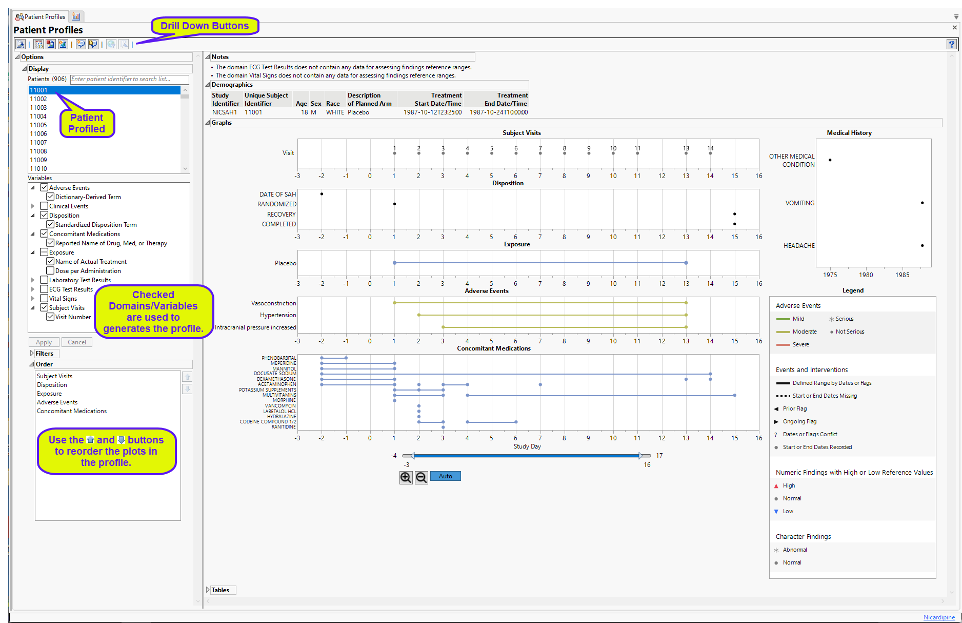

Running this report for the Nicardipine example using default settings generates the Report shown below.
In addition to the profile shown above, the report also contains the following notes window.
The data window contains any notes generated by the report.
Note: The Patient Profiler now responds to and honors selections made in the Review Subject Filter.
Note: Prior versions of JMP Clinical had precompute functionality in this report. This functionality is now managed automatically.
The Patient Profiler window contains the following elements:

Graphs
The Graphs tab contains the following elements:
| • | One Subject Profile. |
This is the principal display. Time1 is displayed along the x-axis and data values from selected domains are grouped along the y-axis. When duration information is available, points are joined with a horizontal line.
Note: For interventions domain, xxTRT is required, xxDECOD is permissible. For Events domains, xxTERM and xxDECOD are both required. When generating the graphs, xxTRT takes precedence for Interventiondomains and xxDECOD takes precedence for Events domains.
| 8 | Use the slider and zoom controls below the plot to adjust the view. Click to reset the view to the default view. |
The color and shape of points is domain dependent and is described in the Legend pane.

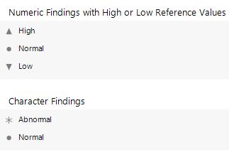

The bottom panel (shown below) differentiates levels of findings for numeric and character findings.
Numeric findings that exceed the specified maximum reference value (also defined as the upper limit of normal or ULN) are indicated by an upward arrow (
). Findings that fall below the specified minimum reference value (also defined as the lower limit of normal or LLN) are indicated by a downward arrow (
). Findings between the ULN and LLN are indicated by a filled-circle (
). The normal range is considered to be the median value over all subjects +/- 1.5 x the interquartile range (IQR). Findings falling within that range are are indicated by a filled-circle (
Normal character finding are indicated with a filled circle (
). Character findings considered abnormal are indicated by an asterisk (

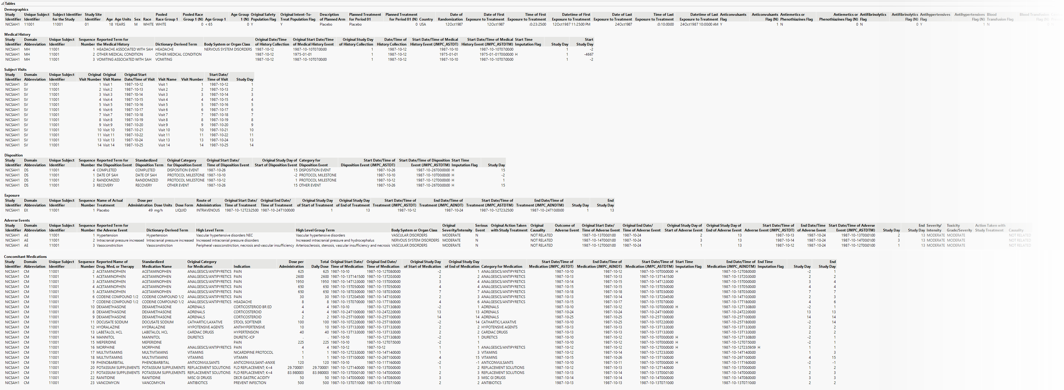

Tables
The Tablessection is shown below:
The Tables section lists and summarizes subject-level data for the profiled subject in tabular form.

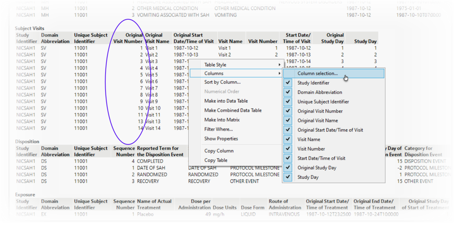

Column Customization in Profile Tables
There may be circumstances in which a user might want to limit the columns shown in one or more of the profile tables. You can use JMP's column selection option to specify which columns are shown in the tables and which columns are hidden. These specifications can be saved to a template that can used repeatedly through the analysis.
In this example, we hide the Original Visit Number column (circled below) in the Study Visits table.

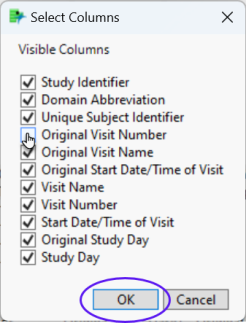

To hide one or more columns from a table:
| 8 | Mouse over the table you want to modify and right-click. |
| 8 | Select Columns > Column Selection from the pop-up menus to open the Select Columns window. |
| 8 | Deselect the Original Visit Number column check box and click to hide the column in the table. |
| 8 | To display the column again, repeat this procedure and reselect the Original Visit Number column checkbox. |
| 8 | To save the template for use in further analyses, click to save the template (see Saving a Review Template for more information). |

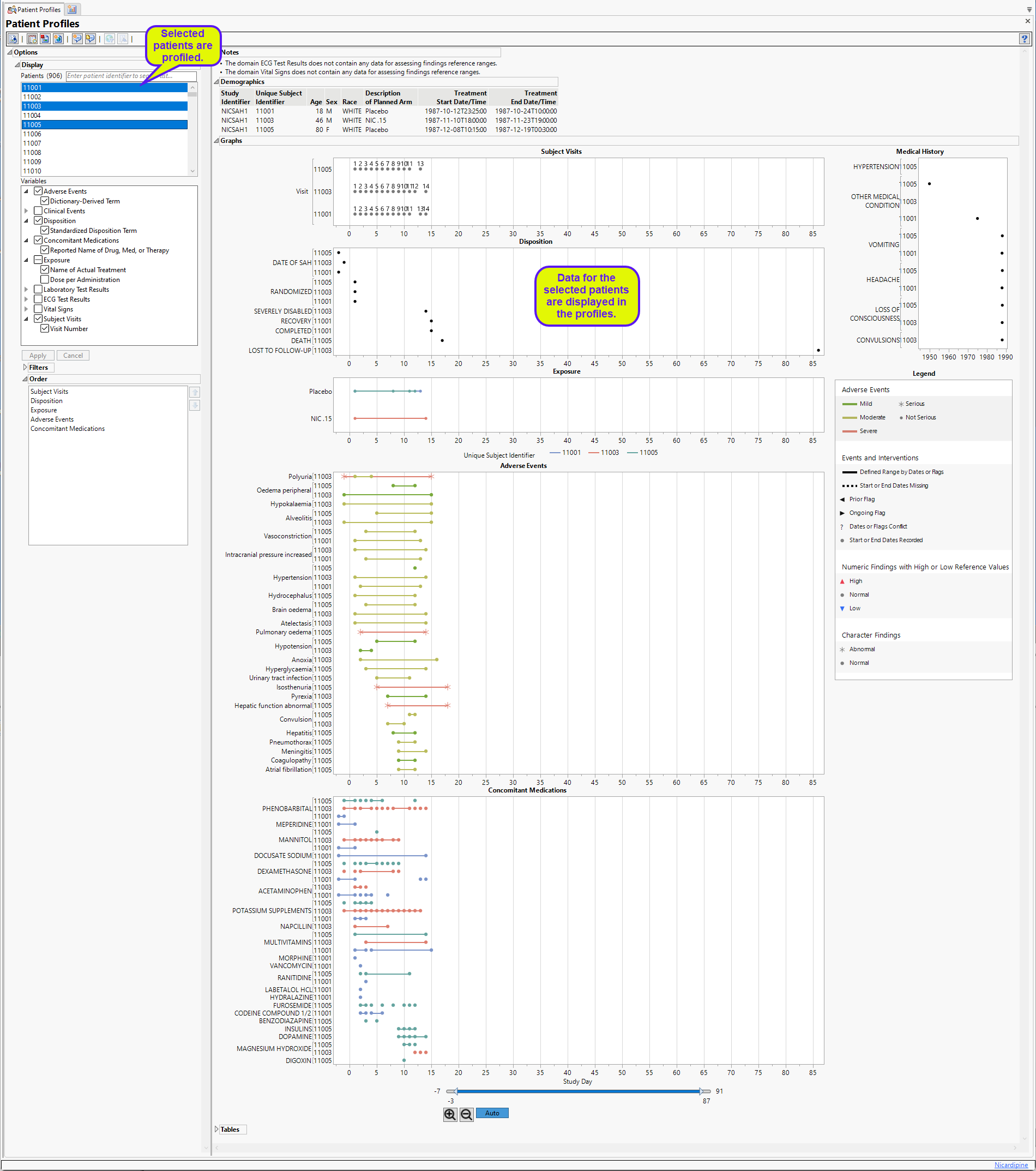

Patients
This widget enables you to select which patients to profile. Hold the Ctrl key to select multiple patients or the Shift key to select contiguous patients among those listed. Shown below is a partial Profile display for three selected patients.
