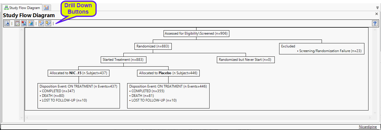

This report generates a flow diagram, based on the CONSORT (CONsolidated Standards of Reporting Trials) 2010 guideline1, to summarize the overall clinical trial data flow.
The diagram, generated from the Nicardipine study, starts with 906 subjects initially assessed for eligibility. Four subjects failed preliminary screening and were dropped from the study. Of the 902 remaining, 883 were randomized and divided into two groups: 437 subjects in the treatment group (NIC. 15) and 446 subjects in the placebo group. Treatment and placebo groups have similar disposition events: Completed (347 and 335); death (80 and 81) and lost to follow-up (10 and 10).

Action Buttons
Action buttons, provide you with an easy way to drill down into your data. The following action buttons are generated by this report:
| • | Click to reset all report options to default settings. |
| • | Click to view the associated data tables. Refer to Show Tables/View Data for more information. |
Note: A wide diagram can be truncated in an rtf static report. To view the entire diagram in MS Word, Select View > Web Layout.
Note: You can change the layout of the diagram from the hierarchical view shown above to a nested or herringbone format by right-clicking on the diagram, clicking Change Type in the pop-up menu and making your selection.
