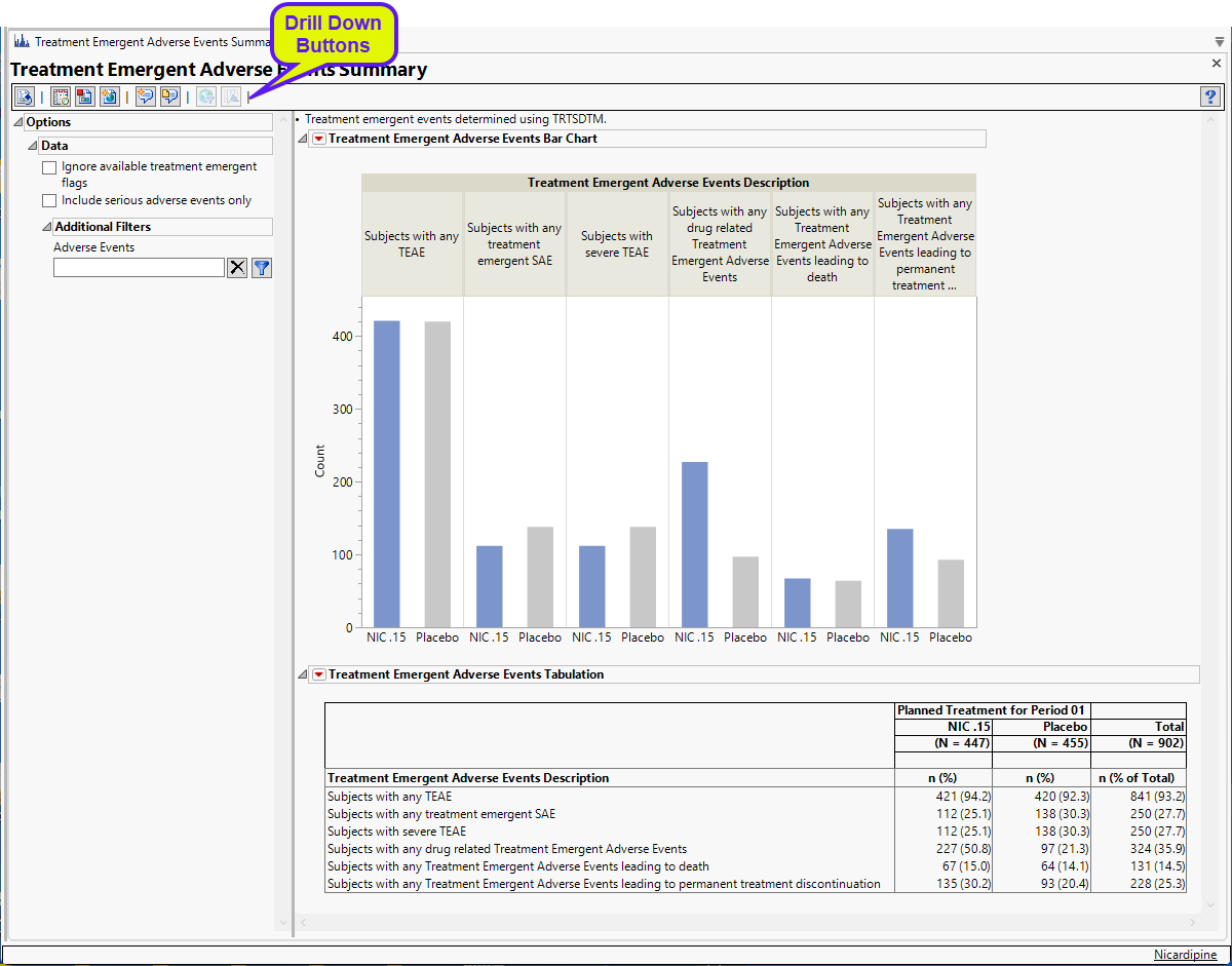

Report Results Description
Running Treatment Emergent Adverse Events Summary for Nicardipine using default settings generates the Report shown below.
The following sections are generated by this report:
| • | Bar Chart: This section contains a Bar Chart summarizing the counts of various treatment emergent adverse events by treatment. |
| • | Summary Table: This section contains a table that summarizes the treatment emergent adverse events. Percentages of subjects experiencing an event by arm are also included in this summary. |

No testing is performed. Analysis is restricted to tabulating counts/percentages of subjects exhibiting treatment emergent adverse events.
Categories are displayed for subjects with any TEAE, subjects wtih any treatment emergent serious adverse event, subjects with severe TEAE, subjects with any TEAEs leading to permanent treatment discontinuation, subjects with any TEAEs leading to death, and subjects with any drug related TEAEs. Serious adverse events are determined using AESER equals Y. Severe events are determined using AETOXGR or AESEV with a value of 3 or greater for the former and a value of Severe for the latter. Permanent treatment discontinuation is determined using records where action taken with study drug (AEACN) is set to DRUG WITHDRAWN. TEAEs leading to death are determined using records where the outcome of the adverse event (AEOUT) is set to FATAL. Drug related TEAEs are determined using the causality variable (AEREL).
