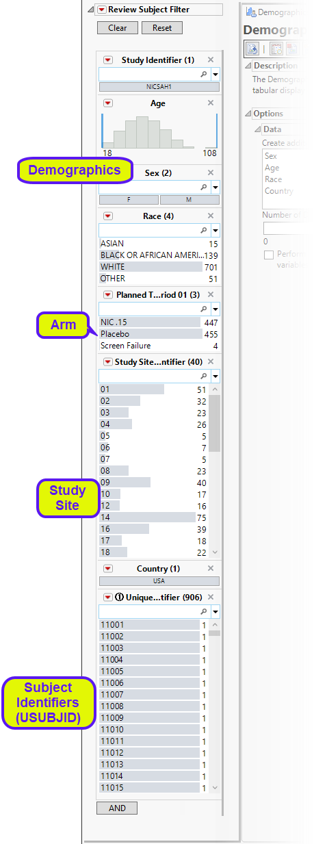

Review Subject Filter
The Review Subject filter is surfaced on the left side of all reports. It enables you to filter the population based on selected demographic or other parameters. Selections made are applied to all reports across the review.
| 8 | Use the Data Filter to select specify criteria for including subjects to explore. Only those subjects meeting the filtering criteria are shown in the subject list. |
| 8 | Click to select a subject and use drill down buttons for further analysis. Use Ctrl-click to select multiple subjects. |
| 8 | Click to select additional columns to filter the subjects. |
