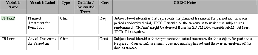

| Variable Name | Variable Label | Type | Codelist/Controlled Terms | Core | CDISC Notes |
| TRTxxP | Planned treatment for Period xx | Char | Req | Subject-level identifier that represents the planned treatment for period xx. In a one-period randomized trial, TRT01P would be the treatment to which the subject was randomized. TRTxxP might be derived from the SDTM DM variable ARM. At least TRT01P is required. | |
| TRTxxA | Actual Treatment for Period xx | Char | Req | Subject-level identifier that represents the actual treatment for the subject for period xx. Required when actual treatment does not match planned and there is an analysis of the data as treated. |

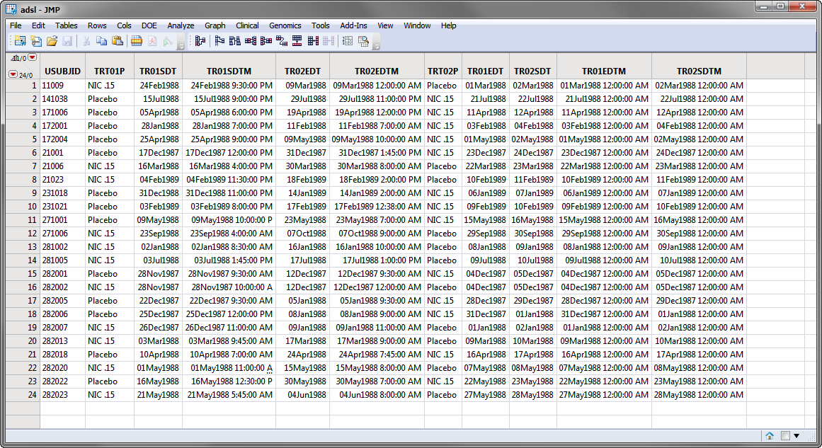

Currently crossover support is automatically detected and used if multiple TRTxxP or TRTxxA variables exist and the associated timing variables for the xx period exist and contain values. Those values might look like the values in the Nicardipine Crossover sample data set, shown below.
Note: For clarity, the majority of the adsl columns in the screen shot below have been hidden using the Cols > Hide/Unhide command.

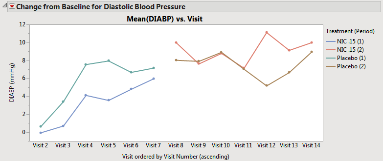

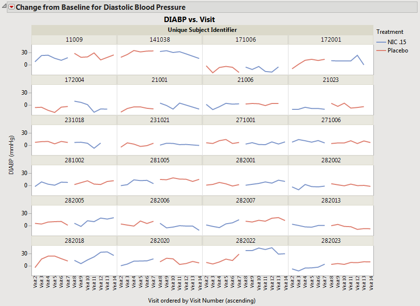

During the report analysis, when adsl is merged into the relevant analysis domain (for example, AE, LB, VS), the adsl treatment timing variables are compared to the timing variable in the domain and new variables: Treatment, Period, and Treatment (Period) are created. The values for these variables are assigned based on the value of the TRTxxP or TRTxxA and the value of the xx in the variable name when the start date of the domain record falls within the treatment period dates.

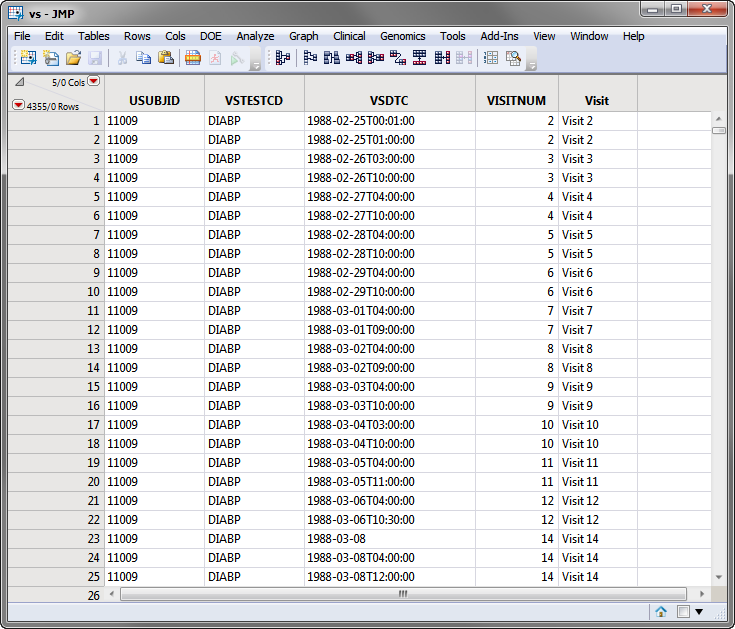

The SDTM data records for a subject can appear as shown in the portion of the vs domain for the Nicardipine Crossover sample data set, shown below.
Note: For clarity, some of the vs columns in the screen shot below have been hidden using the Cols > Hide/Unhide command.
Based on comparison of the VSDTC date/time (note that SDTM follows the ISO 8601 date/time standard) with the ADSL timing date/time, the subject records are assigned to the first treatment for Visits 1-6 and the second treatment period for Visits 7-14.

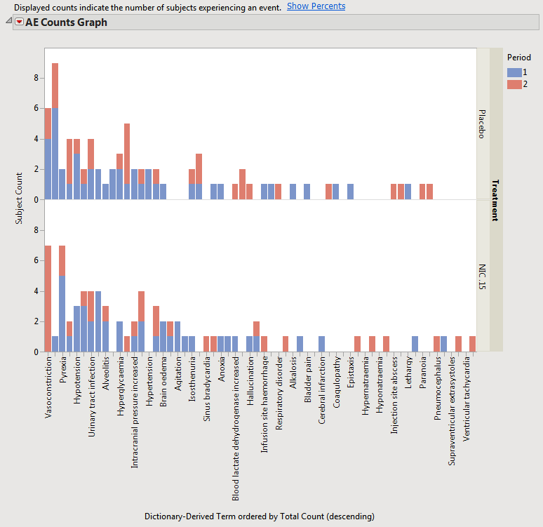

When a crossover study is detected, the distribution results automatically categorizes adverse events by treatment period.
This view is similar for Interventions and other Events domains for distributions.
